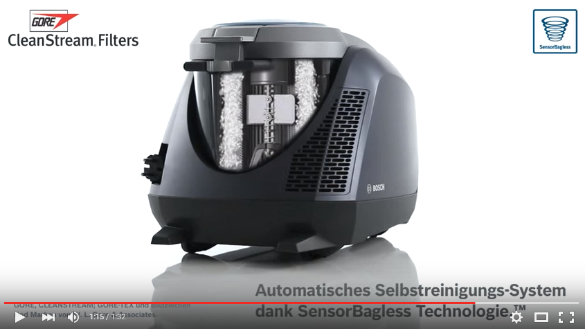

I bought a cyclonic Bosch BGS5ALL1 Relaxx’x ProSilence Plus, and it has pretty good specs and very silent. Do you think I still would need a dust collection system?
In my opinion, yes. A dust collector is designed to run all day without getting warm. A typical shop vac will start heating up as soon as you turn it on.

This Particular Vacuum has a special feature with a spining plastic that taps the filter from the inside repeatedly and makes the dust fall into the main dust receptor, and it cleans itself. (Precisely to avoid clogging I believe).
