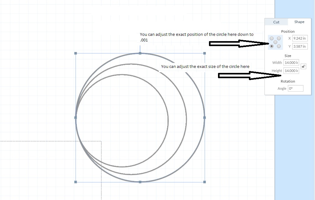

What do you mean about Easel not allowing precise circles? You can adjust the X any Y sizes, and adjust their X and Y positions, as well as defining whether they are to be cut on the line, outside, or inside.

hey man check this image out you can adjust all of that stuff in easel down to .001" honestly I am not that good yet in Inkscape to fix that svg perfect :frowning: but I have created things like this in easel before with no problem it is just going to take some time but if i understand you correctly it can be done
as far as bringing a svg into easel I believe the svg has to be created at the exact size that you want for it to import the same size how precise are you talking about here? .01", .001", .0001", or .00001?
