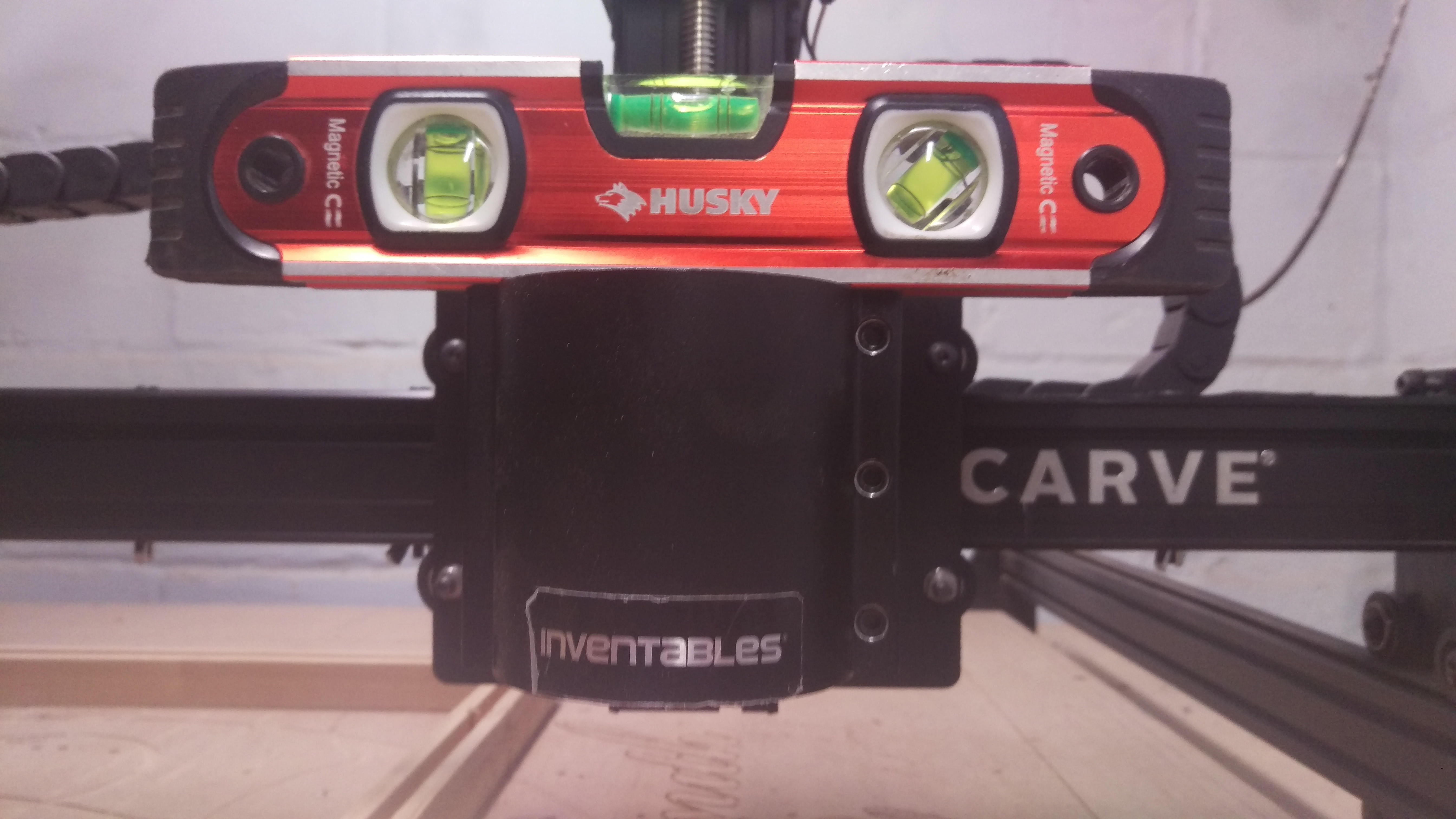

I understand we are not looking to see if everything is perfectly level maybe I came across wrong I’ll add some pics so you can see what I’m trying to determine I actually have mine apart now anything you wanna see and compare let me know I’ll up load any pics you need
this means there is a problem with either the z or x axis we are just using the level to diagnose here not to tell if your table is perfect just to measure any difference between the axis to find what needs adjusted .
I was trying to show him how to diagnose his machine, my machine is level so to reproduce what he might be looking for I had to tilt the level hence the gap.This has nothing to do with "being level " or being precise you use the level as a tool to locate what is out of whack . You are basically using the bubble to find what axis needs fixed nothing has to be even close to level for this to work as long as they match. If you put the level on the waste board and the bubble goes half way to the left then put it on the router and the bubble is all the way to the right then put on the x bar and it goes half way to the left again your problem is in the z axis or the carage.
Just trying to help he can readjust things until the cows come home if he doesn’t understand what happened and how to check for what is the point.
Well I checked how level the router bracket was even though as Phil noted using a level isn’t the best option and the X axis of is was dead on the Y was off just a bit. So I am going to skim the waste board as Phil noted. I also put a level on the entire board and the X is level but the Y is not…yet the entire table is matching those same results.
