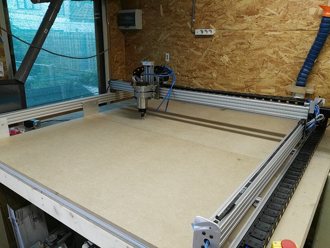

Hi
After using and learning with the Xcarve I tought it was the moment to make a choice. I wont bigger and stronger
Or rebuild the xcarve to something bigger…Or building a new one.
I took the choice of a new one. Living in Europe and had the possibility to buy Makerslide MAX 80 x 60mm
Bigger and stronger and the price is affordable.

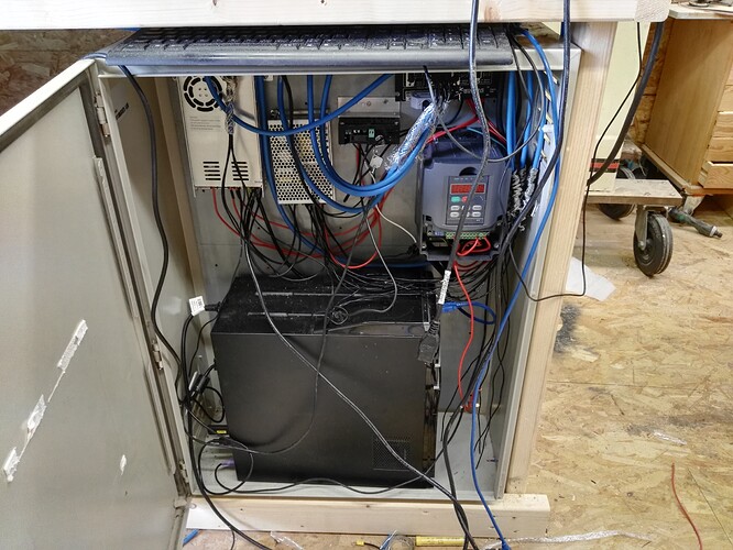

It turns out in a machine x axis 1500mm Y axis 1800mm. Upgrade the z axis ordered a 1.5Kw spindle with VFD and running Mach3 with Gecko540.
All shielded cable Home /limit switches hall effect sensors air assist, bigger cable tracks. Now searching for a waste board that size.
But a photo tells more then thousand words. I m now at the stage for the electronics. That s for the next weekend.

Very interested to hear how the optical limit switches work for you (assuming those are optical) …
Hi darryl
These are not optical, these are magnetic sensors. I read about optical that there are maybe some problems with dust.
Time will tell

I just take a look and its NJK-5003C It switch around 10mm. I took a little higher for safety reason. You can also take 5 or 3mm.
I ordered them on aliexpress and its was around 27$ for 5 with magnets. So if it won’t work , not a great lost.

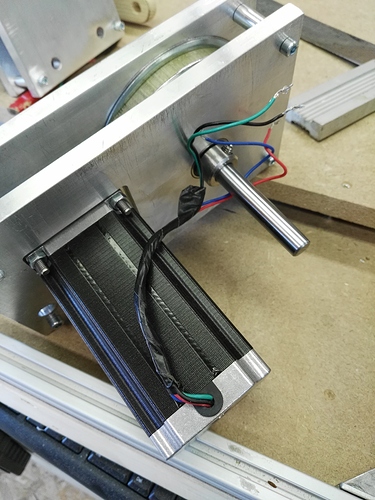

MAker some progress again. Didn’t like the belt drive. Machine is running well but too slow for this size.
So next upgrade rack and pinion. base reduction little pulley 20teeth big one 60 will be 1/3
rack module 1pinion 20teeth
i placed some spacers between the wheels to make place for the rack.
with belt driven I could take it to 4.2m/min 6mm bit 3mm passdepth not bad but want stronger and more secure. belt stetch to much on 2meter, 9mm belt

parts are back from the machineshop. because i don’t have an xcarve at the moment I had to go too the machine shop.
alu plate 10mm thick, bearing 28outside 12mm inside, shaft hardened steel 12mm, reduction 1/3, i will shorten the shaft if all at right place.
but now the gantry plates are way to thin and weak. so draw new ones. also make these in 10mm alu.

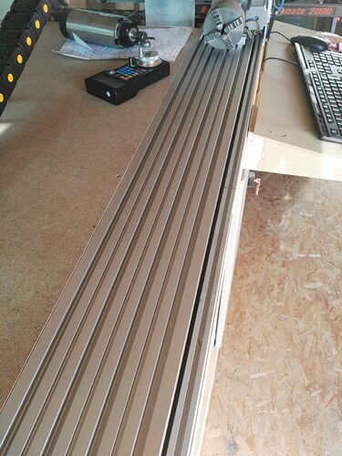

Maybe you saw already on the photo, the 4rth axis also arrived. he is gonna stand in front , on a sliding floorplate.
So when not in use I take off the tailstock and I can use the whole wasteboard
.Its a 4 claw chuck powered with a nema 34. Max opening 100mm. I wanted a 4 claw for clamping all kind of material. I knew from the early times on the woodlathe. A 3 claw chuck is verry common in metal.

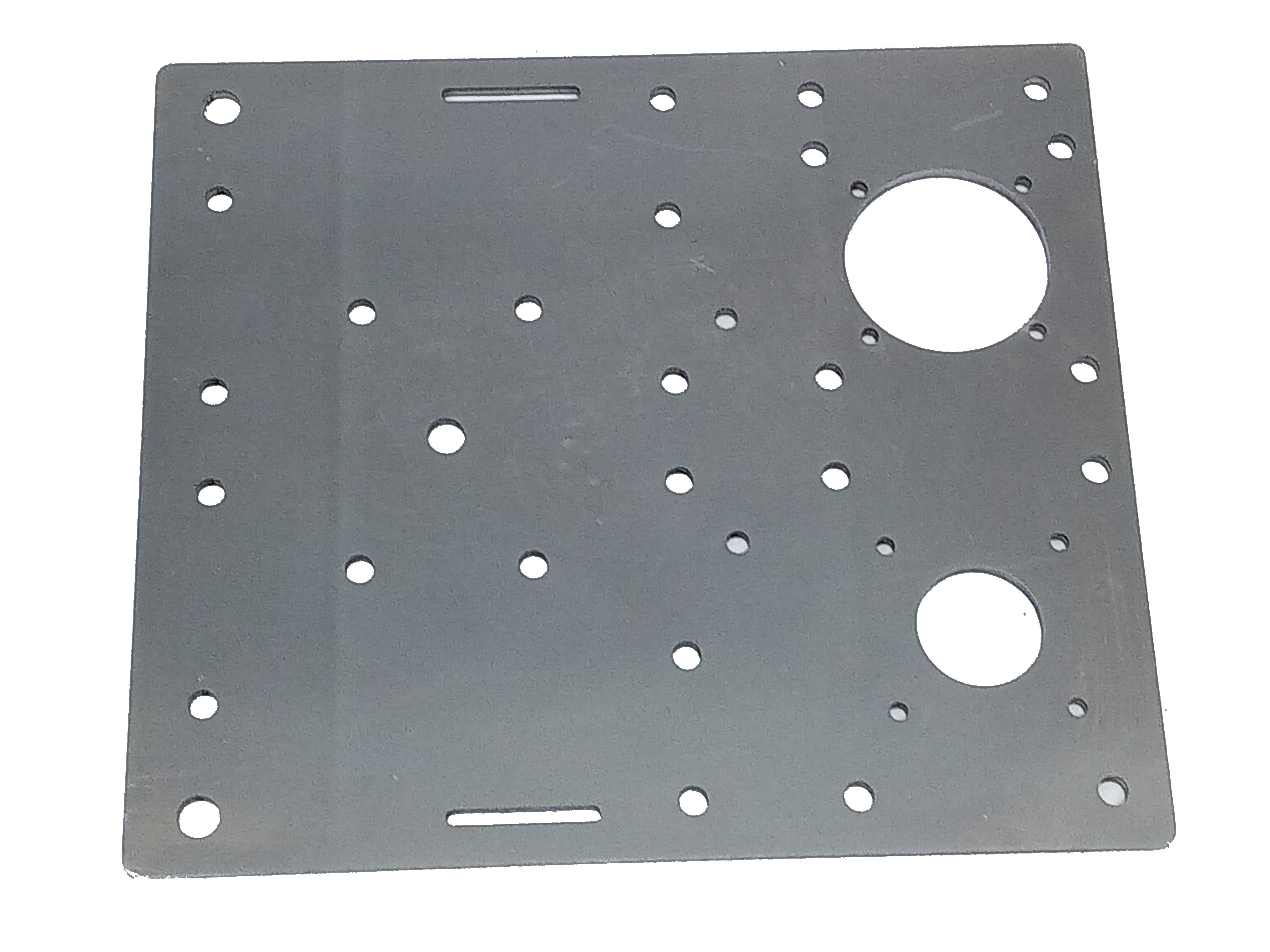

The aluminium for the gantry plates arrived, nothing special but also the plate for sliding the A axis.
Instalation is for saturday
