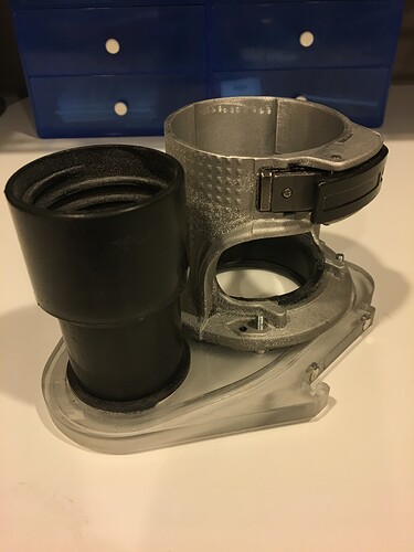

I’m doing a ton of modifications on mine, one is to mount the vacuum shoe to the Z axis - so that it moves with the router not fixed. With that I’ll be modifying the brush to be clipped in rather be pressure fit.
Here is the vacuum base modified using an extra 611 lower collar. I cut about an inch off the top, and a 1/3rd from the mounting sleeve on the z base. I’ll upload more more soon.
