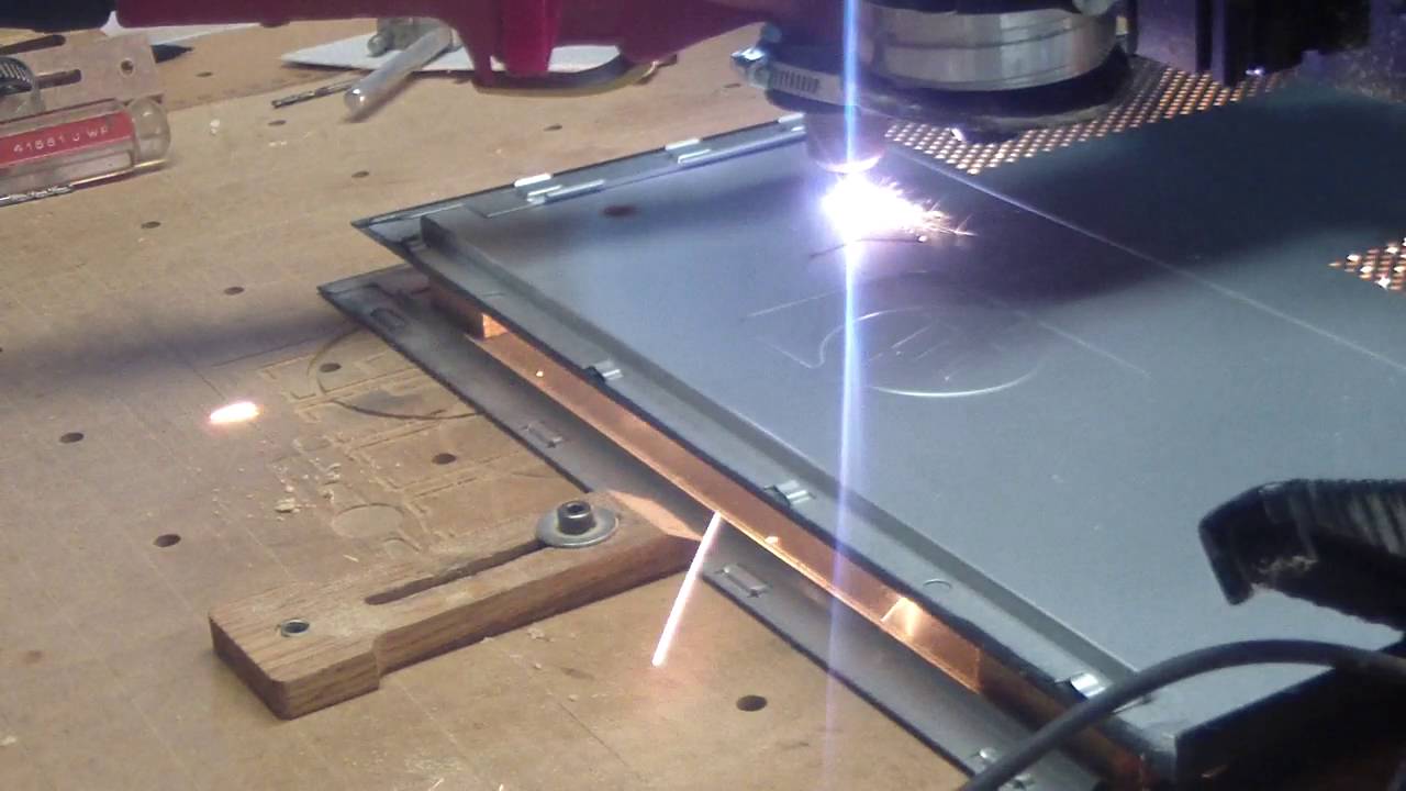

If you want to go the cheapest route for plasma cutting you can get a CUT50 plasma cutter from ebay for around $200. If you plan on using a xcarve with a plasma cutter the set up is fairly easy if you dont mind doing some simple mods to the plasma cutter. the wiring for the trigger can be connected to a relay that is powered by the spindle control. The mount I used was made from aluminum on the xcarve and mounted to the side of the spindle holder. I made a plasma table that sat on the wasteboard and thermally insulated it. the hardest part is insulating the xcarve and nearby connected electronics from the RF energy given off by the plasma discharge. Best recommendation is ground everything and run the plasma on it’s own circuit with the plasma cutters ground isolated from the rest of the system.
Here are a few of my projects that were made from steel. I will tell you the x-carve don’t really like it and the machine could suffer damage if done incorrectly and even if done correctly but really there is no correct way to pull this off many hours and dollars went into testing and plenty of let downs along the way.
