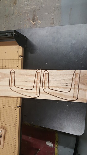

Here are the results I’m seeing on a project I’m working on.
I feel that I turned the POT up enough. I’ve seen people say “one notch” I believe I’ve gone up to 3 notches with same results with each notch raised.

So an update for everyone. I started testing the Max/Min of the POTS but found that I had to have the Y POT almost at the max to prevent the binding.
I’m not sure what made me go back to the V-Wheels on the eccentric nuts but I loosened them all so that they could all spin freely and found that the Y axis moved much easier and smoother. I went about readjusting the v-wheels and didn’t realize how little the nut needs to be turned to stop them from spinning freely.
In short I micro adjusted the v-wheels and calibrated the POTS for the bigger spindle and I was able to do a .3 mm plunge at 80 inch/min into oak and Walnut. WOW!
Anyway, was able to get the project from yesterday done in no time.
