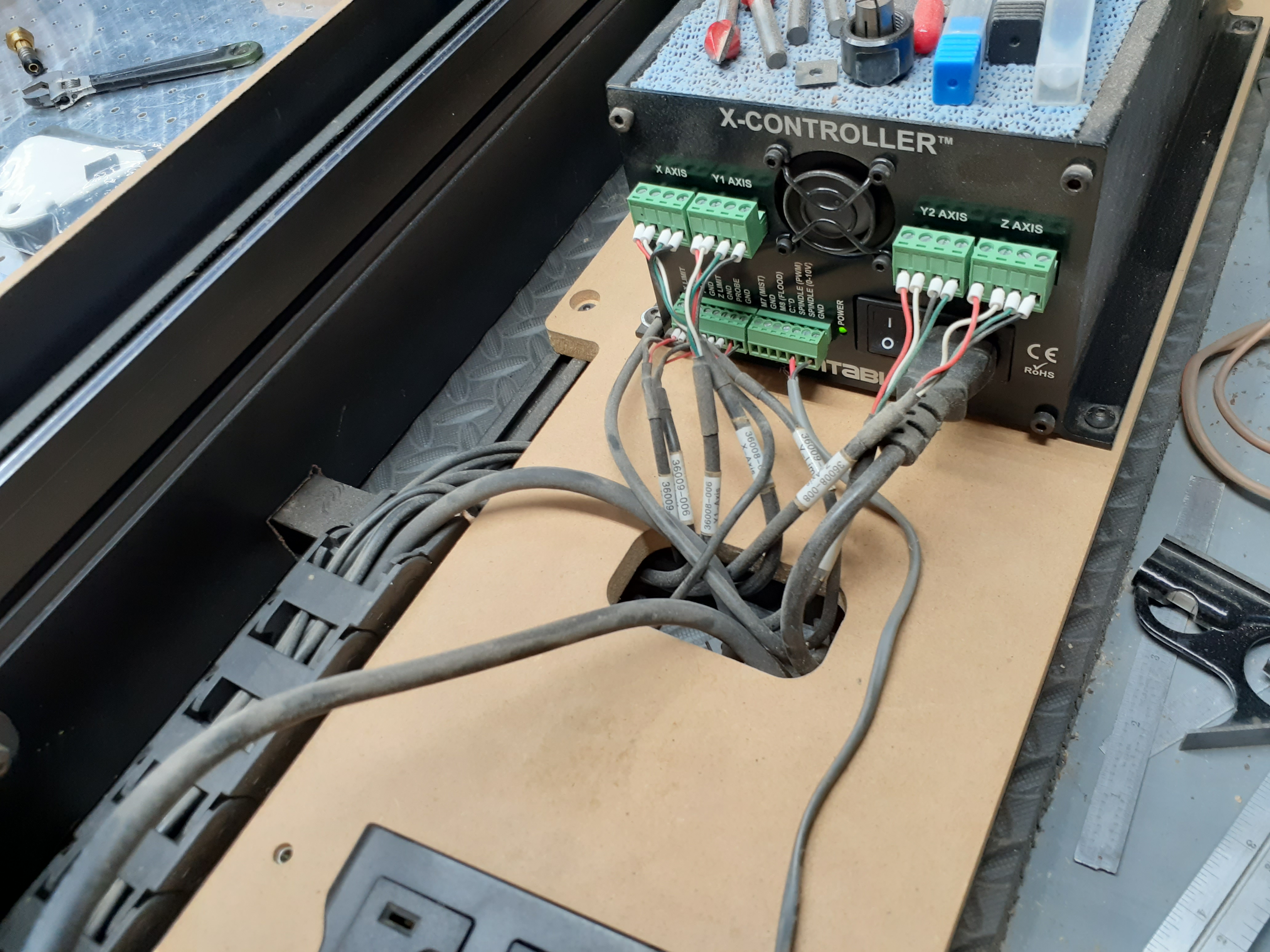

Hi,
I’m finishing up wiring the X-Carve and I’m a bit confused that the spindle (router) doesn’t connect to the X-controller. Also, I’m a bit disappointed that there isn’t a quick start tutorial anywhere, at least I couldn’t find one… So my question is when I go to run it for the first time, do I have to manually turn on the spindle and set the RPM? Then press “go” on the controller and then it will do the rest? I’m assuming this is the way I’m supposed to run it. Any help is appreciated.

That would be exactly what you need to do. Might keep the router set on 1.
I’ve never moved the router from the 1 speed setting.

Thank you, very helpful. What output lines do I use on the X-controller to control the relay?
As they say, A picture is worth a thousand words.
Perfect, Thanks!
Is that just normal electric wire making the connections from the X controller to the new box?
What two things do you have plugged into it? A vacuum?
Its bell wire that I had laying around.
I really don’t know the gage, (18???) but all your doing is sending a signal to the relay.
I have the spindle and dust collector plugged in.
