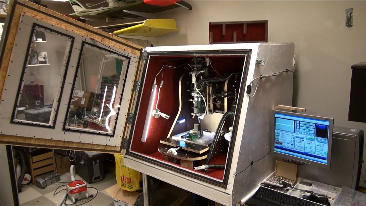

I have the X-Carve here in my office and we’ve had it running successfully for a week or two. The problem is that (expecially with aluminum) we get resonance and chattering in the machine and my coworkers object to the screeching noises. (6061 aluminum, 0.15mm depth, 4 inches/minute, four flute Ti coated bit).
I know this isn’t enough information to really tell anything but I’m looking for any place to start so I don’t have to tell my engineers they can only play with their toy at night.
If the mill is in a separate room, you can sound proof the room pretty easily with green glue and some additional drywall.
Otherwise you can build a sound enclosure for the mill
Check on YouTube - you’ll have better luck searching “shapeoko” than with “X-Carve” as people have had a lot more time to work with their Shapeokos… https://www.youtube.com/watch?v=uTGKKVcKJm0&ab_channel=tjshape
@LeonGrossman - Anything that will absorb the sound, or dampen/reflect it into different directions will help. The same stuff they do in sound studio booths will work. Eggshell foam, put an enclosure around it, etc… In your case, the high frequencies are more harmful and annoying, which is good because they are generally easier to control or eliminate. Try Googling soundproofing without the reference to CNC machines at all, and you should be able to find some interesting and helpful ideas. Good luck, and be sure to post your findings and experiments so we can all benefit. Also, thanks for giving the details on your aluminum milling. I am always interesting in anyone milling aluminum with a X-Carve/Shapeoko.
BTW, I want to say high pitched screeching can be cured with a faster or more aggressive rate, but I could be remembering wrong. Check out HSM on Youtube.
