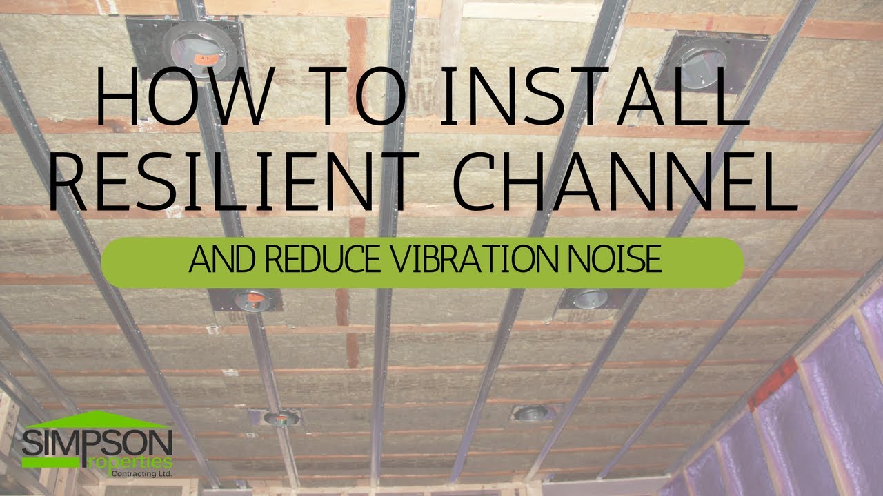

Not necessarily. Think of sound traveling through the air. When that sound (which is simply vibrations) hits another surface it will cause that other surface to also resonate. What you need to do is to stop the vibrations (decouple) with a false wall by using resilient channel. Think of it as a sound shock absorber. This will absorb the vibrations and not retransmit them to your neighbors.
SR-500 might also help. It works by converting noise into a low-grade heat. The heat can then be dissipated easily. With the false wall you will lose around 45mm (2 inches) of room per surface, but it works exceptionally well. Instead of foam use something like Roxul. Home Depot should carry it. Resilient channel works incredibly well but you’ll need to buy drywall with it too. This video shows how to install it;

I’m a nocturnal animal and its tough not being able to run most of my tools in my garage late at night when I prefer to work. I found this, http://www.instructables.com/id/Soundproof-Your-Garage-Walls-Using-My-Cleat-Meth/ , while trying to figure out how to keep the noise down in the backyard shop I’m planning while not breaking the bank or over complicating it. I may be mistaken but from what I understand it’s a similar concept to the resilient channel that X-CNC mentioned.
While it seems to be the best bet for me since I’m building from scratch, as I plan on just running all of the electrical in conduit and dust collection tied into the cleats. I’m not sure how well it would work in your situation with the garage, outlets, and whatnot already in place. Obviously I don’t know your budget or how big you want to go to tackle this, but there is always the option we used when I use to build high end home theaters of building another room within your room. You could build these cleat type walls over the existing walls of the alcove and then add a front wall. Or maybe just build a small “room” out of some heavy packing blankets to take the edge off.

There are profound differences between using a cleat, and using resilient channel. When using resilient channel the sound vibrations are reduced down to traveling through only the mounting screws. However with the cleat the sound is being transmitted through the entire cleat, plus through however the cleat is mounted. At the very least I would put something like Stinger RKXTK Roadkill (stick on damping material) on either side of the cleat. This would add mass to where the sound vibrations are penetrating.
