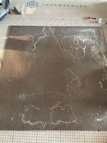

I’m noticing than the machine isn’t cutting all the way through consistently through the workspace. I’ve attached the finished product that I extracted from the stock by sanding the back side and the waste board.
It’s missing in the middle front to back and more strongly on the left.
Is this most likely a sagging center of the waste board issue? I checked the height of the y axis bar and it’s within 0.005 inches at each end.
Do What Mark Said! You need to have a parallel plane wasteboard in order to have even bottom of your workpiece and this accomplished perfectly in one way: Surfacing it.
It is also a common practice to ADD another MDF board atop the stock one so that it can be fully surfaced since the stock one cannot be entirely reached with the spindle…
While it is most likely that your wasteboard needs to be surfaced to ensure it is parallel to the machine as mentioned, it is also a good idea to surface your stock as well depending on the material being used.
Is that Especially with a V Bit, the top surface of even planed flat. or even Sheet goods are used, the top is never perfectly parallel to the spindle movement.
To Get perfect V-Bit carves there are 3 realistic options:
Surface the wasteboard and use Sheet Goods that are not cupped, twisted, or bowed AND Plane any real wood… AND HOPE FOR THE BEST.
Repeat the Prior Option AND shim the board as best as you can while using the spindle with a bit in it to gauge the top being perfectly parallel… (this is a bit more time consuming but works better than option 1 but not as good as option 3)
Surface every workpiece (and if plywood is used refer to option 2) If painting or Staining, then surface and paint/stain on the CNC without removing for best results

Here is an example showing a planed flat Board VS a surfaced on the CNC board. Notice the consistent depths and thickness on the CNC’d one vs the varying depths, and thicknesses in the Planed flat one.

That said, the results are worse
I’m attaching some more pictures.
The full one was a previous carve with minimal missed areas on the left side.
The others are of this latest one. I scaled it up from 11.5” wide to about 15”. I removed some of the more detailed snow flakes. But it missed a lot more spots.
The mdf was bought two days ago. It’s clamped at all 4 corners and no noticeable sponge in the middle. Is it at all likely the mdf needs surfaced? I wouldn’t think this fresh on a manufactured material would.

A straight top is different than a top that is parallel to the spindle’s movement.
Kinda, surface engravings will not be perfect UNLESS the top surface is parallel to the spindle movement.
