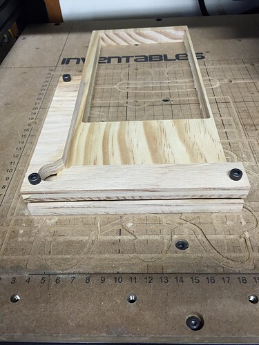

Hello everyone i thought I would share a clamp design that i have been working on today this will help with having a solid right angle to support material
Let me know what you think and if you can think of any uses for it

oh sweet yeah it was more or less inspired by carvey I am planning to incorporate a zero touch plate into it also
@Mike
hey mike i like your thinking could you elaborate on your idea a bit and I will see that i come up with?
So here’s my thought:
In this project you can see that there are slight differences between the two pieces. They are meant to stack on top of each other and provide an origin guide AND a clamp.
To use them you’d first take the one with the thinner legs (it’s the one closest to the origin in the design) and use the middle hole on each leg (the one with the countersink) to bolt it to the wasteboard. This is your origin. Next, place your material on the X-Carve. Then, take the piece with the thicker legs, and using the remaining holes, clamp it down. As long as your material isn’t too much thicker than the origin guide this ought to work quite well. It won’t work at all if the material is thinner than the origin guide.

@ontheEDGE It seems like you’re doing most of your work on thinner stock than your guides. The idea I had won’t work that way. It needs material that’s thicker than the guides/clamps in order to work.
I may cut a set of them out to demonstrate, but I don’t think I have any stock that’s big enough right now.
yeah i haven’t really cut anything over 1" yet i deal alot with the thinner stock but i like your idea and look forward to seeing you make a set i am actually going to cut a set of yours out myself
I just found a piece of plywood that this will fit on, so I’m gonna cut it out and set the guides up so you can see what I’m talking about :slight_smile:

Ok so first things first, don’t cut a set of these out yet. The holes aren’t right because I threw this together in too much haste. I will fix it and re-share it.
Second off, this would be step one:
Yes I know there’s only one bolt in place. They don’t line up right, remember?
Anyway here’s step 2:
When I fix the holes I’ll add countersinks for the top part so the bolts can get some extra grab into the threaded inserts on the wasteboard.
Yes, you’re right that you sacrifice about 1/4" on the bottom and left sides of the material. But, if your wood isn’t totally flat, it can help a great deal.
A few washers on the bolts would act as spacers to let this system work for any thickness of stock.
And here’s the new file with the correct spacing for the holes, and countersinks for the top bolts. I use 50mm bolts and they ought to work just fine for this project, but I don’t have time to cut another set out tonight.
