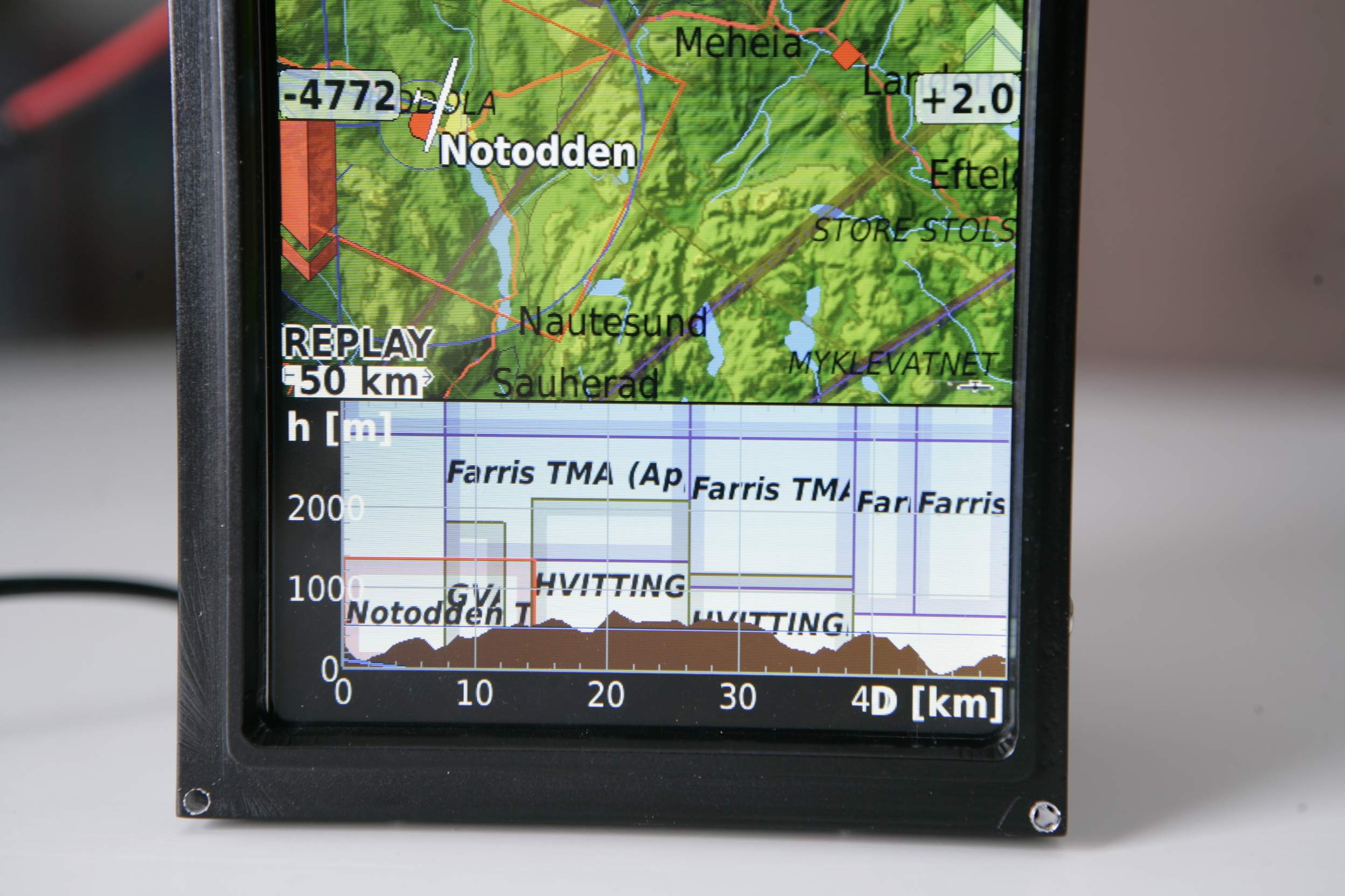

I am performing a pocket carve as shown in this file:
I notice the spindle retract many times, moving to the opposite corner = a lot of time wasted moving in air.
I would assume that the fastest way is to just go around continuously and adjust the carve width of the pocket?
How can I optimise my Easel Pocket to avoid this? Or is there a smarter way to accomplish this?
The carve is removing material from the backside of a LCD mounting frame, hence the asymmetric pocket width.
Correct, back recess for the screen. Bit is a 3mm 3F 45deg Helix upcut bit, running 1200mm/min and DOC 0.1mm
I am not using an X-Carve, my CNC is built cheap and simple and not rigid enough for bigger bit when milling aluminium.
Though I haven’t tried a bigger bit I fear my rig is too soft to accommodate. For now I can trade off with time milling. as long as I have a consistent cut and minimise stops etc I am happy for now.
