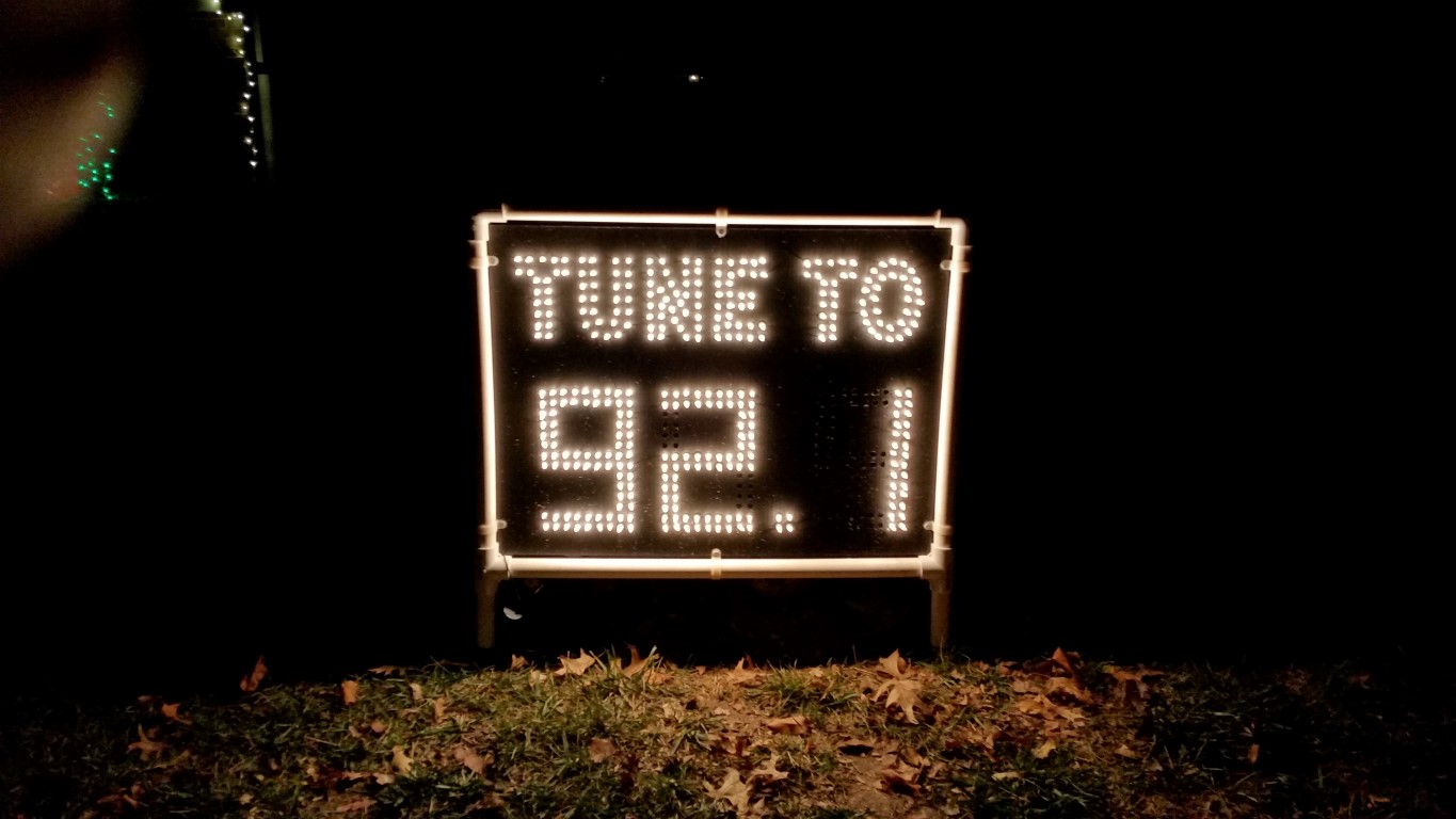

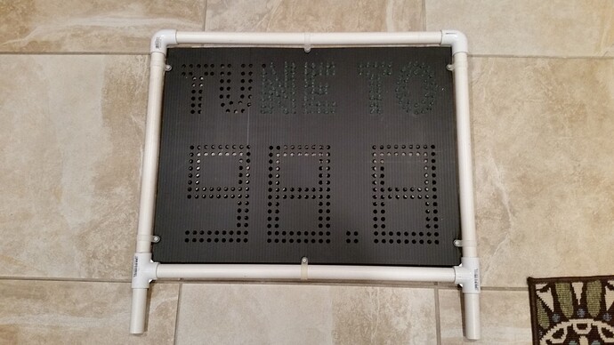

My son needed a sign to display the FM channel for the background music of his outdoor Christmas decorations. Since it is only running at night it didn’t need to be anything fancy. Used some black coroplast from Home Depot and cut the roughly 400 holes to accept the lights. Set it up so if he needed to change the frequency at some point it would be no problem - just move lights around. Worked out well.
I used Inventables Solid Carbide Single Flute Upcut End Mill #30238-02 and it cut it pretty clean. Tried the typical upcut and down cut 1/8" 2 flute bits but neither cut it nearly as well.
