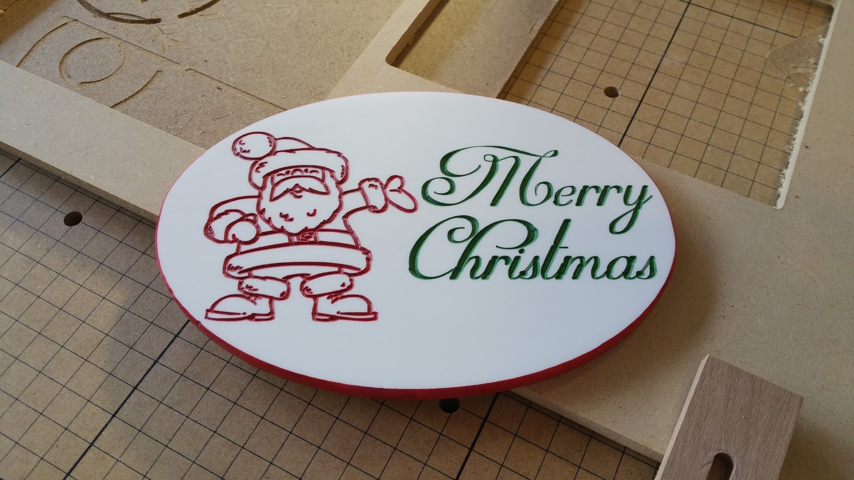

After I carved the Santa and text, I just dabbed the paint into the cut areas…I was not very careful…after the paint dried I took some 400 grit sandpaper and removed the excess. The paint on the surface came off after a second or two of sanding.
