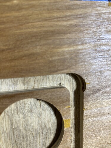

I upgraded my x-carve to 9mm belts and 269oz steppers. I went to do my first real carve and noted the square is a parallelogram (yes a square is always, but you know what I mean). Belts are tight enough. Steps seem pretty close. What is up? You can see that one weird corner where the first layer slipped out. As I need to get this job done, I’m going to carve it on my Tormach (double check flood coolant is turned off!)
The circles are not perfectly round / with flaws is indicative of uneven tension (greater backlash component) between X & Y. When motion transition from X -> Y or vice versa the weaker axis will “trail” behind causing the anomaly. I would also doublecheck any set screws and pulleys for slippage.
As to the deviation in low/outer right corner I dont have any ideas except the bit “dug in” for some reason, another indication of pulley slippage.
If the square is skewed that can also be indicative of a trailing Y-stepper / pulley slippage. (or simply not squared to begin with, but I assume you have control on that part :slight_smile: )

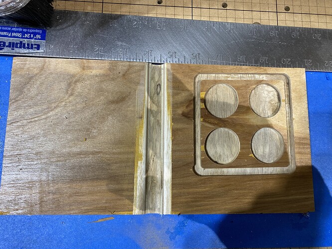

Ok I squared the stock with a t-square to the Y rail. This was a throw away test piece of birch ply. Sorry the t-square has a little parallax in the photo because of how I had to hold it while taking the pic whiles not blocking the light.
Again I got that weird corner carve. That seems like a repeatable thing so I guess it could be a bad path planning on v-carve’s part. The 3D carve of the molding came out beautifully smooth. The weird part about the corner is right there the layers don’t align but the rest of that pocket is perfectly aligned.

I don’t think it’s a toolpath issue. V-Carve does a zig-zag “ramp” which is slightly better than a plunge. A true ramp, like what Fusion can do will definitely help, but that really looks like you have some slop somewhere.

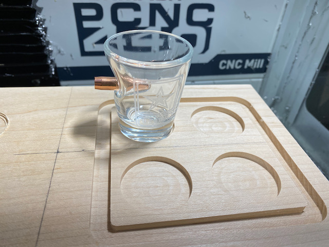

In the need to get this done, did some test running here on the Tormach and hopefully tomorrow will get it done in the final walnut after testing on this scrap Maple. The z-stepdown on the pocket was .125" by default which was waaaay too harsh, but big and heavy beats chatter! Had that been my usual metal that mill would have snapped:
I adjusted the circular pockets into an adaptive path for the real one. The pockets look lovely.

On the Tormach? In Maple? What sized endmill?
Here is the “real version” in paduk. Came out beautifully, although I think I set the DOC too shallow on the adaptive for that rectangle. All cuts were with a 2-flute 1/4” either straight or ball end:
The 3D adaptive + steep/shallow strategies did an amazing job on the groove in the middle. You can’t feel the edge with a fingernail it feathers in so well… After this it’s off to the laser for 3D engraving the logo in.

@NeilFerreri1, as an update to that weird jog outside the cut path on the corner as seen above, that turns out to be the crazy way V-carve Pro’s tool path generation does a step-over. I don’t really like their tool path generation in that they do their stopovers with a retract and plunge. Sure you can ramp the entire pocket (which works great in Z) but to step XY it does a plunge move. So if it doesn’t clean up perfectly it leaves those outpouchings. I had a similar problem on an oval pocket last night (although it did successfully clean up the edge). Once you use Fusion’s tool paths it’s hard to use others. But I have to say the post-processor for the x-carve for Fusion isn’t great (I tried it yesterday and it didn’t start my dewalt (but did strangly start my “flood” (which is really my dust collector)), luckily I had mis-cut my stock so it was air-carving with the spindle off for a second - amusingly I spent like 30 minutes debugging the g-code for the job last nigth why the holes I was cutting were off center, until I finally decided to double check the stock I had cut (Apparently I had cut the plywood 3" to small… luckily it’s just 1/2" CDX so pretty cheap mistake). So no mistake in my CAM job just a mistake in my table-sawing…
Those hops that cause that outpouching.
