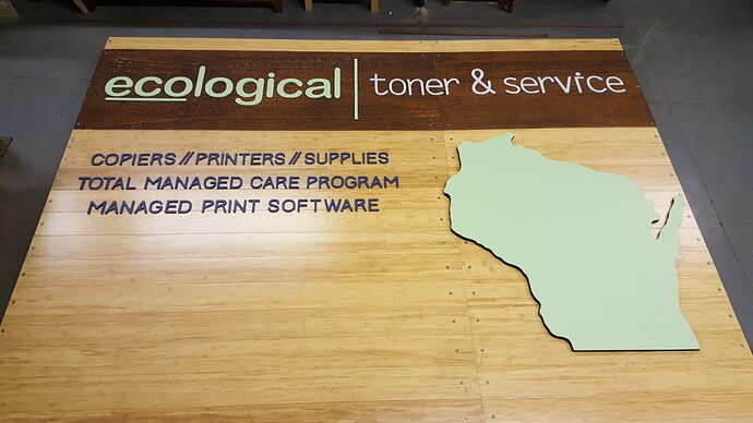

No worries. I used an all in one paint primer by Dutch Boy. Its an interior latex satin enamel. I did one coat. let it dry for a couple days, then hit it with 220 grit and then one more coat. Thats it. I used a .25 inch think MDF for the letters.
couple more pics of progress.
Uploading…
the blue letters are not permanently in place yet. I have some dividers I am going to be putting in between each line.

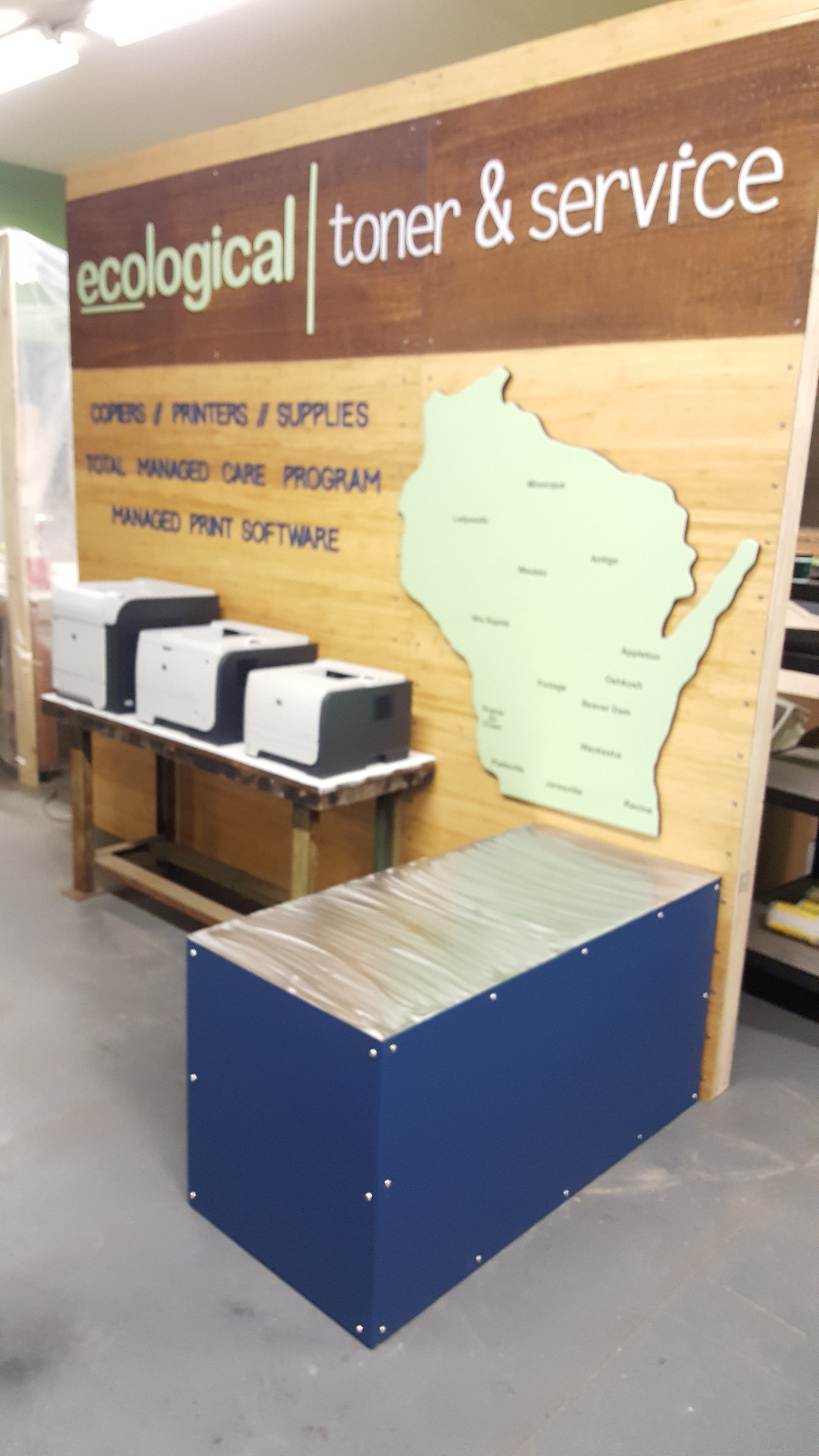

moving along… I have to be finished before the 29th so will be getting the rest finished this week.

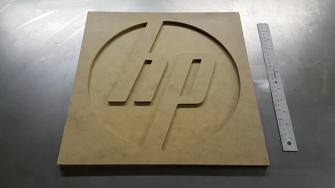

getting closer… Made some HP logo signs today.
Looks amazing , you did a fantastic job here and should be proud of this work.
