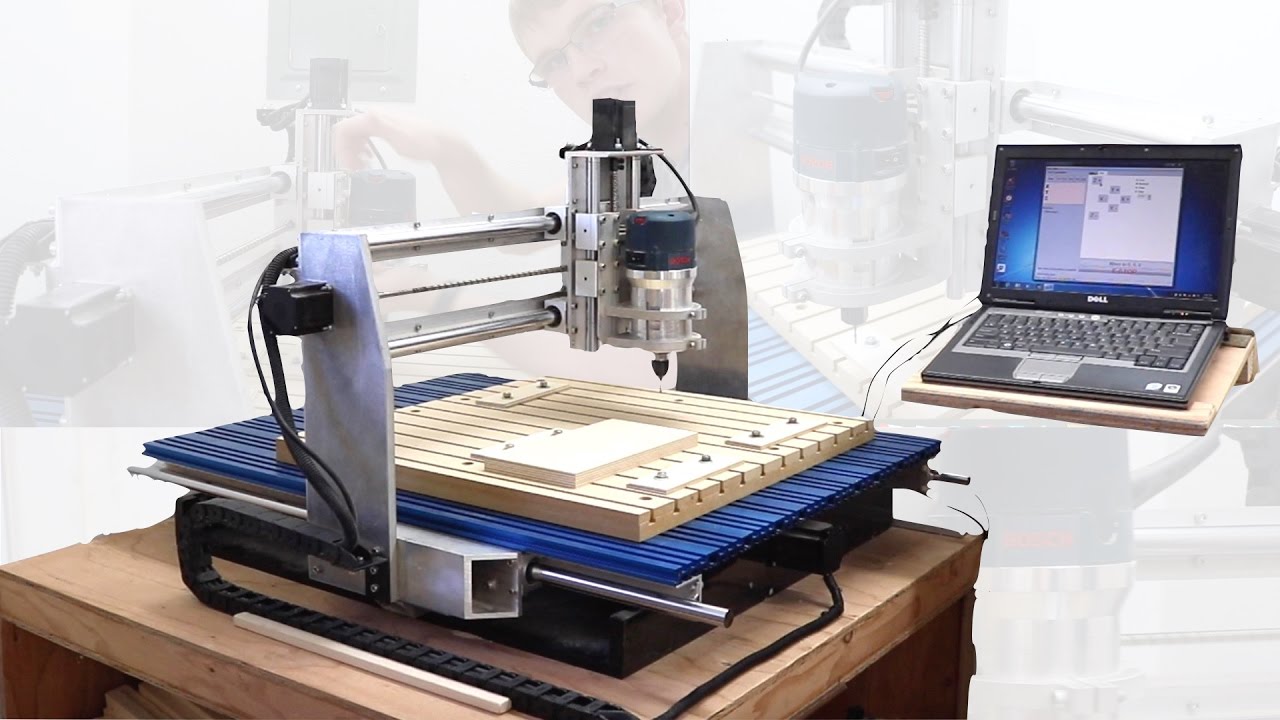

Here’s one solution from Youtuber Jeremy Schmidt - it’s not an X-Carve but the same principles could apply. Details start at about 10:50.
