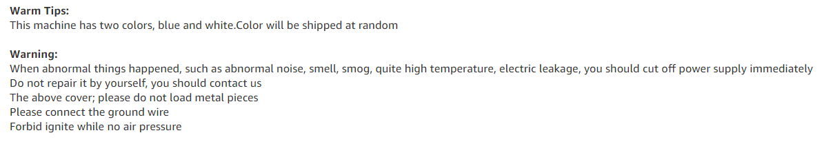

Description:
Synthetic glass (acrylic) polishing, Oxy-hydrogen generator is a machine using high temperature flame to make acrylic edge smooth and bright
The heat polishing on the acrylic rough surface can be achieved as long as the flame passing by gently, and the acrylic products will become glittery and bright
Used for:
Heat treatment for metal parts
Weld the hinge of spectacles rim
Seal the injection glass bottle, conforming to GMP industrial standards
Fuse the lead or tin alloy plate for storage battery
Cut and fuse quartz or fine parts etc
Peel off FPC of computer, fuse LED chip and thermocouple
Weld jewelry made of gold, silver, copper, lead, tin casting etc, such as stud, safety pin, chain etc
Polish irregular acrylic surface. After polish, the work piece will be smooth and shiny.
hho generators are pretty simple in design and build from everyday parts. And if you assembled and set up your xcarve then this is a very simple task. just remember to use a a flash back arrestor at very least.
@ShaneBell After finding the HHO generator, I found a bunch of info available and some great videos on YouTube. It does seem easy to DIY but then again working with hydrogen, I would rather have one that has been designed and manufactured by a professional!
