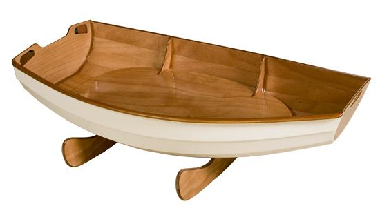

Funny you guys should mention boat building. John Harris at Chesapeake Light Craft gave me permission to use his DXF file for the Eastport Pram. Without giving away the design, Iā€™ll be showing how to manually index the parts on a XC1000. When used 1:1, it makes a very cute boat just under 8ā€™ long so it can be cut out of sheets of plywood. At 2:1, it makes a 4ā€™ long coffee table or cradle.
http://www.clcboats.com/shop/boats/boat-plans/sailboat-plans/eastport-pram-rowing-sailing-kit.html
http://www.clcboats.com/shop/boats/rowboats/dinghies/baby-cradle-pram.html

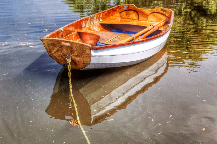

Yes, sheā€™s got a cute little high aspect ration lug that I use to scoot back and forth across Green Lake in Seattle. I also did Duck Dodge on Tuesday nights on Lake Union last summer. Her big sister, the Passagemaker has a gunter-sloop rig, which I canā€™t wait to buildā€¦:sunglasses:
The mast fits into a socket in the forward thwart. The mast step butts up against the forward bulkhead so that you have both silicon-bronze screw and wood-flour epoxy fillet strength to transfer the load to the hull. Super simple, super sexy!

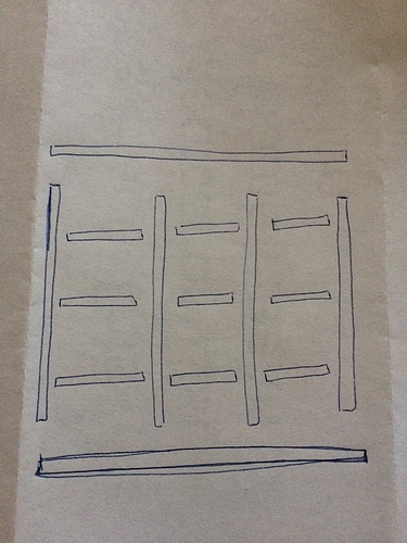

I disregarded the stock table bc it is not very ridgid and I am not using these pieces at all. I have based this decision on the Cubed Root Rule for stiffness. Think of a guitar brace, the taller the braces are, the more stiff the soundboard is. I upgraded the foundation of my table to the 20x40 for the extra stiffness
I would also replace the cross bracing with 20x40 as well. If you want to use the 20x20, use six 20x40, 4 of which run parallel to one another (could get away with 3) and two perpendicular to the others on the ends.
Use the 20x20 to tie the 4 parallels together. Keep the 20x20s as short as possible, they will have the most deflection.
This setup will stiffen the entire wasteboard. Just using the 20x20 in the center will only stiffen the perimeter more. This will allow the center to sag, possibly even more since the center will technically be floating 20mm above the surface of the support table. Adding the 20x40 across the center of the wasteboard will be necessary if you widen the perimeter supports as well.
Donā€™t get me wrong, IF the supporting table is sturdy enough, the 20x20 will suffice. Just keep in mind that the 20x20 will be using the support table more than a 20x40 to obtain the same amount of stiffness. This will require connecting the two together to act as one unit.
Michael Grigg: Could you provide a drawing of what you are describing? Iā€™m having a hard time trying to visualize all the cross bracing you describe. Thanks.
Here is a quick free hand sketch.
The long pieces are made up of 20x40 extrusions where as the short pieces are made up of 20x20 extrusions. I still recommend using 20x40 extrusions for ALL of the base but this process will add more ridgidity over the stock base. And allow the use of the 20x20 extrusions.
This method does require more connecting hardware, but thatā€™s a given bc there are more pieces and more intersections to stiffen up.

Thanks. That helped a lot. I agree that 20 X 40 extrusions for the entire base is probably the way to go.
This is exactly what I did as well.
