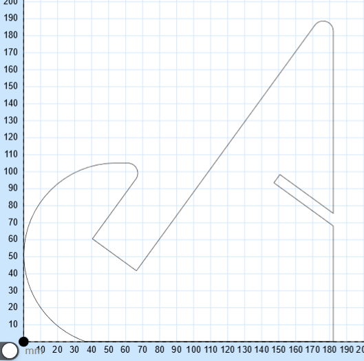

my problem is, if I make a part in for example Solid Works, I save it as a .dxf import it in Adobe Illustrator then save it as .svg
Then I import the .svg file in easel the small thin lines are visible. Then I want to carve the outside of the part, click on outside carve, because for sure I want to have the measuring that I have designed.
Then Easel wants to carve the lines on both sides outside, so it takes a lot auf time and the measuring are not okay.
Here a few pictures:
Here is the contruction in Solid Works
Import the .dxf in Adobe Illustrator:
Import the .svg in Easel:
Set it to “outside”
Then there are “2” Outlines :
I dont know why, had anyone a solution for my issue ? And know how to solve it?

i sued adobe illustrator i found that have you had dual lines on the drawing. when add color you can see that some line that are not connecting so you have join them

is the program by chance exporting the line weight?

I was having this issue in Inkscape, I found out I have to remove the line outline and keep the line fill. This creates a single line when importing. It also accounted for the wrong size cuts. Now I use a thin line (Filled only) and the same with any shapes I create. So if I make a circle and do no outline, and only use fill, size it, then import into easel. I get a nice solid shape, the right size, that I can cut with any option without the double line issue.
