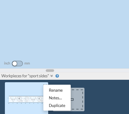

There is a notes option in each workpiece tab on the bottom row. It’s not for the project but useful on each tab.
Just to add on what Rudy is talking about.
On the bottom you have your different pages for Easel, bring your mouse to the top right corner and a window will pop up that has Notes in it.
When you save a note to a page it puts a symbol in the upper left hand corner as a reminder.
I usually do what the others mentioned above and you can also rename the workpiece itself and that will be a little more obvious as it appears across the bottom of the preview you could name the workpiece “Notes” or similar and that might indicate to other users that they should check the notes.
BUT you could make it even more obvious by creating another Workpiece and using the text function to just write notes into the project itself, set that as the first workpiece if you want them to see it for sure! :grinning:
