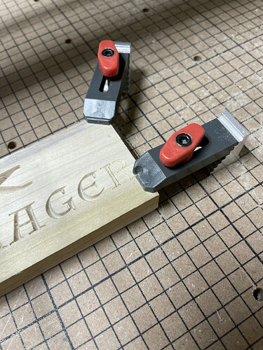

I set the project up with with correct measurements, checked and rechecked. Get it clamped down to the waste board, run the simulation again and verify that none of the clamps are in way of the tool path and run project. Once I started, it carved all the way to the end of the board and into one of my clamps. Walking through the pre carve checklist, everything seems to go correctly. I set the z, set the xy on the bottom left of the material and take off. What am I doing wrong?? What part of the setup am I missing? Please help getting extremely frustrated!!!
Edited: First picture is a shot of the tool path. Didn’t appear to come as close to the end as it did. The second you can see where I had the clamps. When I get home I can upload a photo showing where it ended on the material. The second photo is not actually a video, I snapped a photo to show where the clamps were placed. The video was at the beginning of the carve.

here are pics of the measurements.
the last one you can clearly see where it went longer than expected.

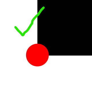

Make sure that you set zero when the center of your endmill is ON the corner, not inside it.

I’m pretty sure that I understand what you meant and I just changed what I think you were saying to change and it started where it should. But for my peace of mind could you elaborate just a little. You mean zero this setting out??

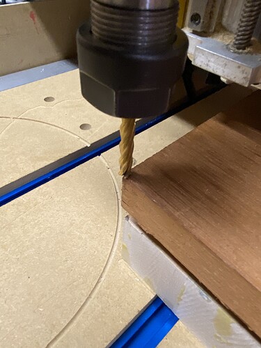

maybe I should ask this question…how do you set zero?? you yourself. when you put the mill bit on the material?
When you set your home position your bit needs to be in the bottom left corner of your material, dont worry about the lines on the waste board. You can place the material anywhere as long as the home position is in the bottom left hand corner.
This is where your bit should be when you set your home position
I get home around 4:00 pm central time and I can FaceTime you or do a video call through messenger tomorrow. If your jogged it like Neil said and it went 12” then everything seems to be good. You may have just been setting the home position incorrectly.
