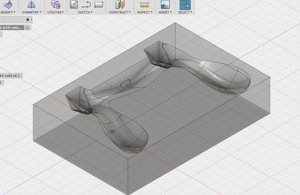

I tryed to cut this controller out of a box for the past 4 days.
but i always end up with this
and the middle section is still attached to the rest of the box.
The controller has some holes at the shoulder buttons resulting in gabs in the controller model and so the box is not cut completely.
So i know where the problem is but i don’t know how to solve this.
I tryed to patch the holes and thicken the patches to get a body. But when i try to cut this body it throws an error saying inconsistent geometry.
I tryed to enlarge the shoulder buttons to close the gabs but still got the same result as in the picture because there seams to still any connections i can’t find.

Thats exactly what i wanted to do. the Problem is the Model is Not one solid Body and is assambled out of more components. The Main Body is just the Controller Shell and is hollow. The shoulder buttons leave a gab at the back and thats why when i cut Not the complete Profile is cut. The Space in the Shell is still left Ehen i cut and is connected with the Rest of the Box. Thats what you See in na picture.

So here is my progress in more detail.
this is the controller model i hide one of the shoulder button components to show that the inner of the controller is hollow.
And there seam to be a little gab between the shoulder button and the controller shell.
And there is a hole on the underside:
This hole is defined by two faces at the edge, so i can’t select the hole as a circle to extrude it inwards to close this gab.
so when i drop this model on a box:
and when i cut this out with the combine tool or with the boundary tool i end up with this:
this is still one body and not the thing in the middle is not a separate body as i hoped. at some points at the shoulder button parts the inner part is still connected to the outer side of the box ( because of the gabs) and there is the connection at the bottom.
The only way i came come up with, is to patch the holes with the patch tool and to make them to a body use the thicken tool.
But when i try to cut with this patted holes i get this error
So im still started with fusion but i don’t know how to separate the inner section or an other way to close the gabs without patching.

What’s a sectional view look like of the inside?
Could you take that model and create an outside shell from it? That would allow you to just remove the whole thing.
meshmixer has a function that will “create a solid body” and there are tutorials on youtube
Here is a picture of the intersect analysis
there you can see the gab between the shell and the shoulder button cutout.
