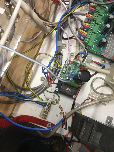

I appreciate the help guys. I will take pictures of my TB6600 board and the way I understand you showed in the diagram. I will also take pictures of the resistors. I did triple check the colors against an online resistor identifier as well as my cheatsheet hanging on the wall. As for the speed controller it is the Inventables speed controller. It wont be for a couple hours yet as I have a few things to do prior to getting back into the shop but that will be the firsat thing I do.

Here is a picture of the board I am using (middle Pic is best) 4 Axis Tb6600 CNC Controller Max Current 5a 36v Stepper Motor Driver Board for sale online | eBay

Hey guys, sorry for the delay. Have had truck issues and then life happened. Larry I followed your instructions and got 4.9 volts. I did notice though that I get full voltage constantly regardless of my mach 3 settings. I do have a new have a new spindle and speed controller enroute. The new speed control has 0 to 10v ports as well. Please correct me if I am wrong but is it not as simple as connecting the 0 to10v together? Please see Below the pics I took. I will have to post again with pics as I used my iPad to take them.
If anyone requires clarification on what is what please just message and I will do my best to clarify. Thanks again.
Russell
With your current setup there are two problems:
  1. you can’t get your software (MACH3) to vary the 0 - 10 volt output from your controller board.
  2. you’re trying to feed a PWM (pulse width) signal from a varying voltage (looks like no pulse width, or pulse width exceeds time slot).
You can eliminate problem 2 with your new speed controller (or by modifying the old one slightly).
Problem 1 is an issue that I can’t address. Look to the documentation for your board and MACH3.
