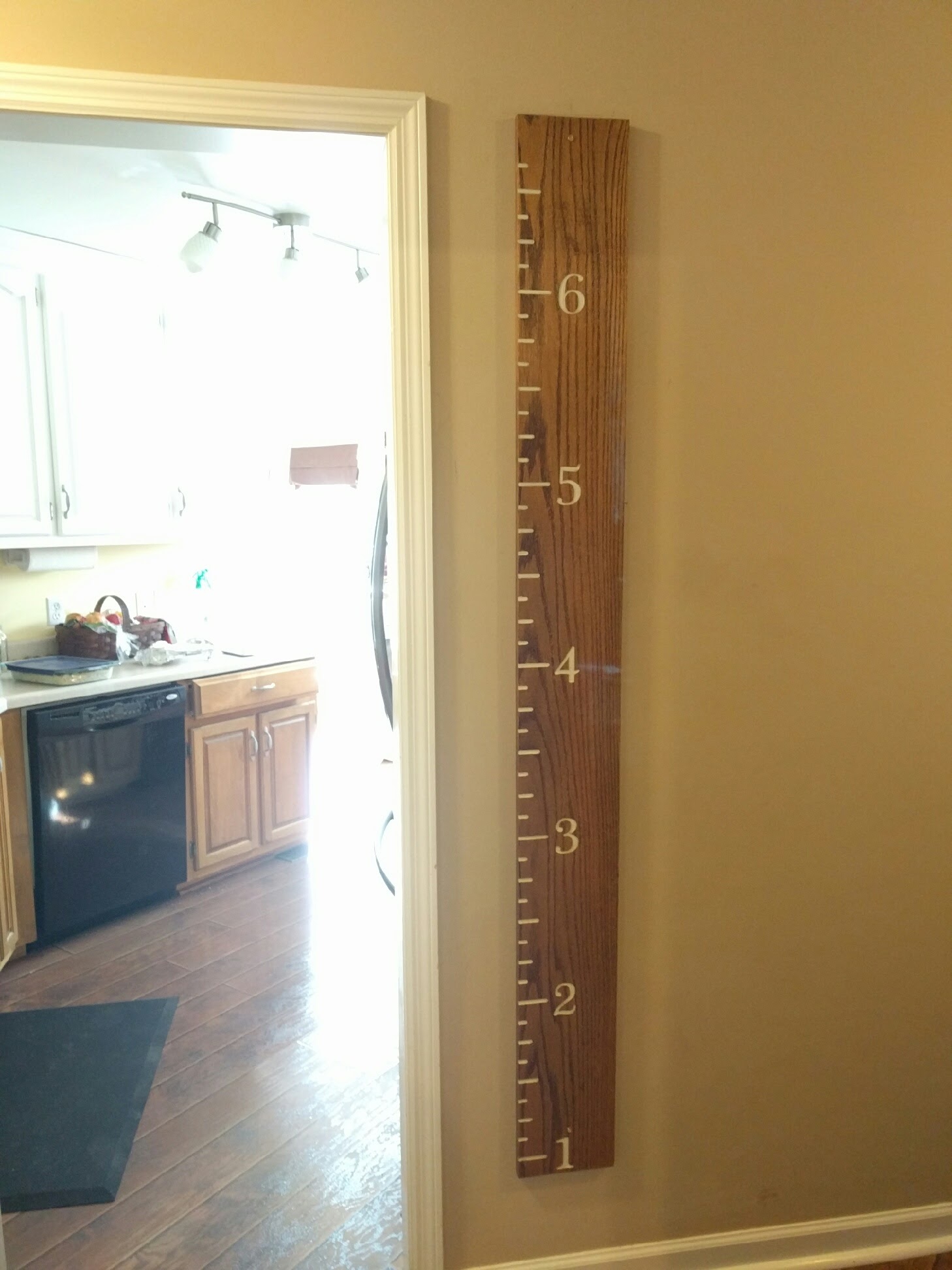

Height chart for our daughter. 3/4" oak. I have a 500x1000mm X-carve so I did 2 ft at a time with an 1/8" endmill and just kept sliding it down. Stained, hand painted letters(ugh…), then polyurethane.

Nice work Adam, what did you do to make sure you were in the exact spot when you moved the ruler to tile that carve?
Honestly I just eyeballed it. I put the center of a line I’d already cut at the zero position in easel and then delete that line. This way if I’m off at all when trying to zero the bit in the middle of the line it wouldnt matter because I’m not cutting it again. Worst I can be off is 1/16th or so but you’d never see it anyway.
