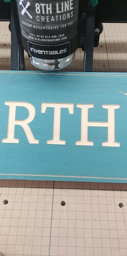

We did a 6 x 21 cedar sign this morning and here is the process we used.
We sealed the board with Poly , you can also use shellac. (Optional we also used a mask)
We first did a roughing pass with an AmanaTools 1/8" spectra downcut bit (part Number 46200K)
After the roughing pass was complete we used an Amanatools 30 degree engraving bit for the final pass. (Part Number 45771) . You could use a 1mm straight bit, but we found the mask ended up wrapped up on the bit.
I have included part numbers so you can have a look at the bits in case you haven’t seen them before. I imagine Inventables sells similar bits.
Here is the sign after the finishing pass.
