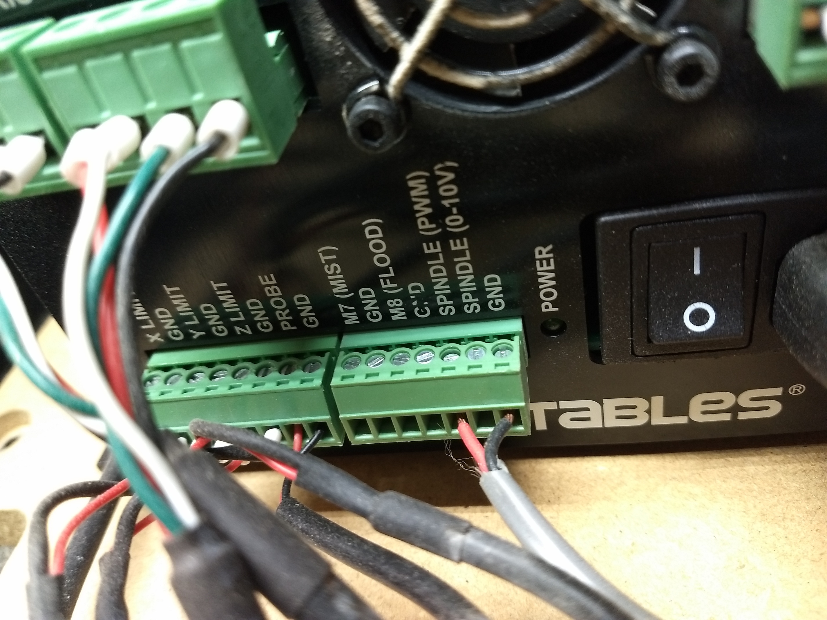

Hey all, I’m attempting to run the same setup y’all have done here, but on the gcode side of things the M3 S12500 command starts up everything, but then after 1 or 2 seconds, the connection is lost and the spindle turns off.
Try the Spindle (PWM) Terminal instead of the Spindle (0-10V) one.
Not being in the market for the 110V IoT Solution I had to make my own which didn’t work at first but after 1-2 changes, one of which was hooking it to the Spindle (PWM) Terminal, it started working just fine.

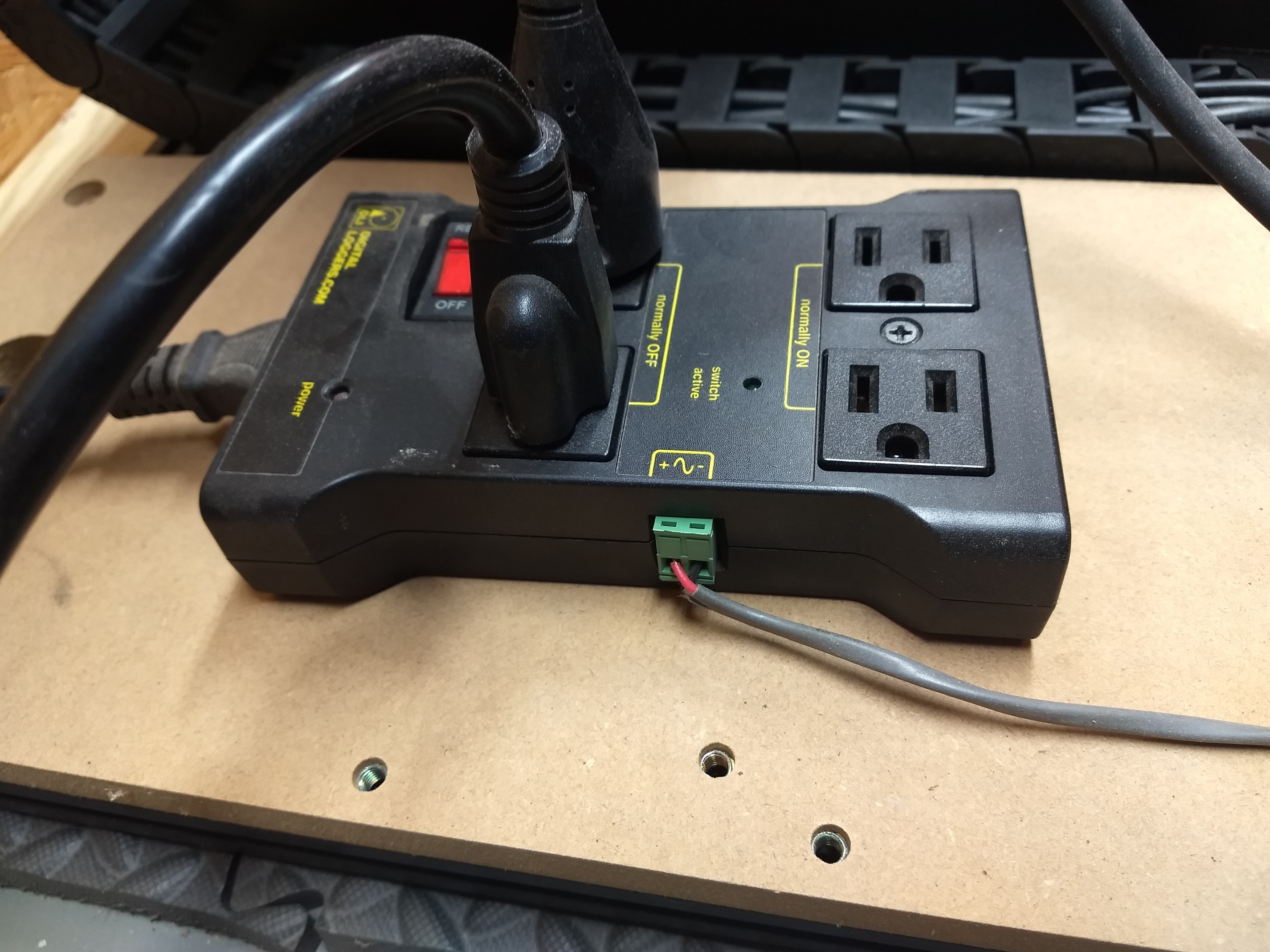

IOT Relay Question?
How does this wire up with the X-Controller for the X-Carve. I am a teacher and I have to pause and shut off the router every evening for my students projects. I was wondering how difficult it is to wire up the the X-Carve?
I do not use Easel at all.
I strictly use Vcarve desktop.
Instead of trying to explain, I thought I would just post a couple of pictures.
I hope this helps you out.
The first picture shows the IOT on its own 20A circuit.
I’ve been using this relay for a month with no problems now all of a sudden when I turn on my power strip and power the relay every so often the relay powers on the router and dust collection for a split second and shuts off. My dust collection is grounded and everything is run in to a dedicated surge protector
