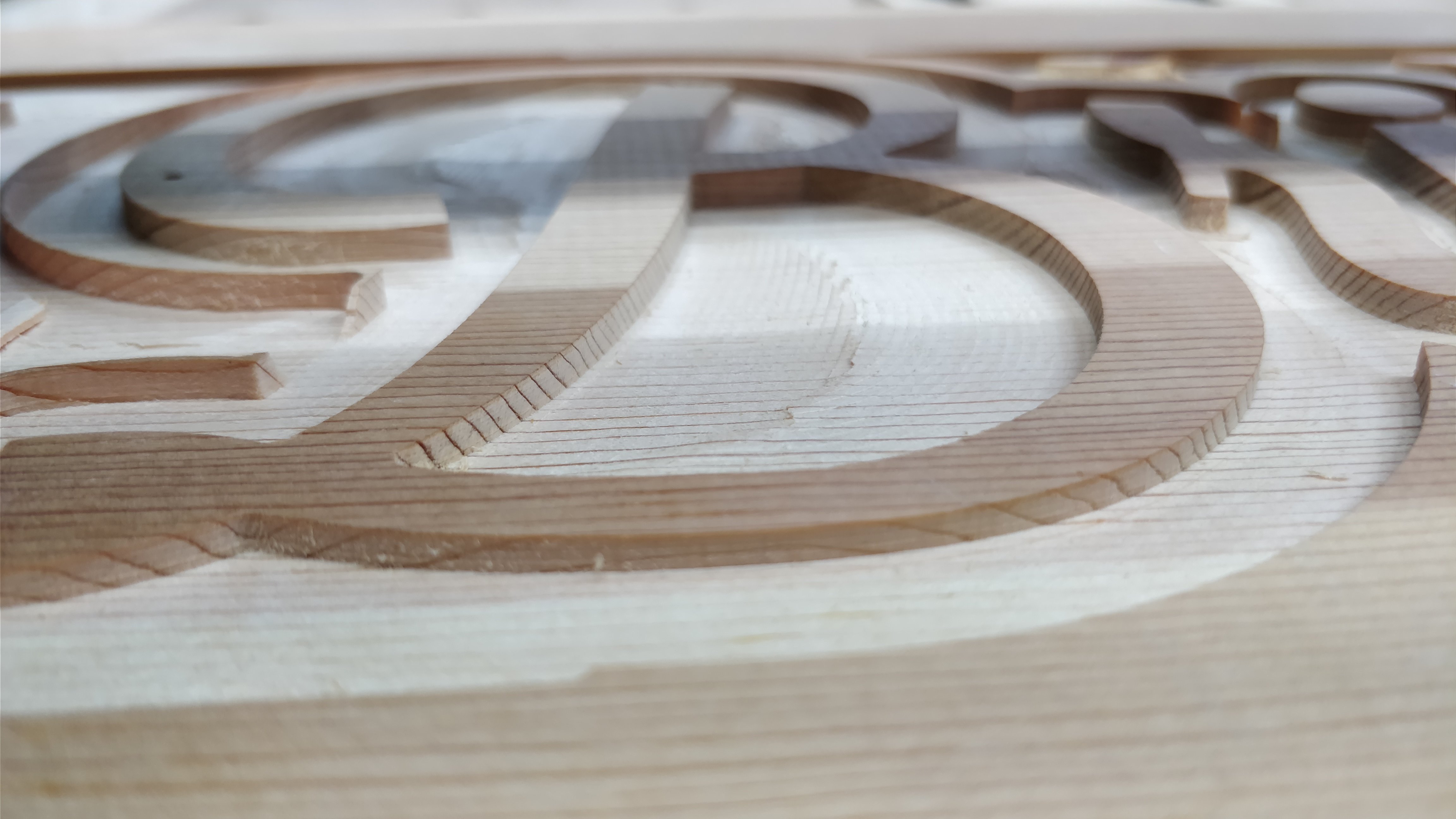

OK guys, I am at the end of my rope.
I have trammed the machine to within a 1/2 mm everywhere on the my perfectly planed wasteboard. All vwheels have their washers. Everything is nice and right, square and parallel to the wasteboard. Voltages are @ 1.34 on all steppers. I have spent the last 3 days off messing with this, I can’t figure out the problem.
When I do an engrave @ 40 ipm in pine, I get this:
The way those ridges ramp upward it looks like it could be your Z axis moving. Make sure your set screws are tight and the lock nut on the Z screw is tight also
I agree with Shane it looked like the Z is not stable and theee is not a consistent direction of error.
Also there is one spot in your pic that has a deep plunge.
