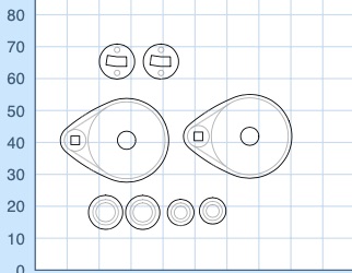

In Easel, I’m making a rough cut with a 1 mm bit and then changing to a .3 mm bit to carve the details. It looks like it’s only shifting in the positive y direction.
I’ve been able to get the rough and idle passes synced on another piece for this project, but for THIS piece, I keep getting this result. I’ve done the idle motor lock thing, and I’m certain that the gantry is not shifting.
Also, I’m not doing this as an actual rough/detail pass in Easel. I set the detail path to a depth of 0 and cut the rough pass, then reverse this after I change the bit. I don’t see how this would make a difference, but it might.

What I want to to is cut out the parts using a 1 mm bit, and then do the engraving with a .3 mm bit. However, when I set the detail bit, easel thinks I want to use it for the entire thing. So I copied the engraving part to a new workpiece. Everything is in exactly the same position.
The error happens whether I do it like this, or if I set the engraved lines to a depth of zero for the first pass within the same workspace.

Yea the drawing looks fine to me. I’ll just throw out a few things just in case…
Are these the actual cut settings you’re using?
Your detail bit is set for 0.7mm depth per pass and the actual carve is only a depth of 0.6mm. It’s been a while but I feel like I have had issues while using a comparable setting. Also, how are you able to use these settings with a 0.3mm bit without it breaking?
I would try setting the depth per pass at 0.1mm and use the 0.3mm bit to carve everything in one run. It might take a little longer but it cuts out any room for error.
The depth per pass thing might be an error, but I don’t see how it could affect the position of the bit. That is something I need to fix though.
