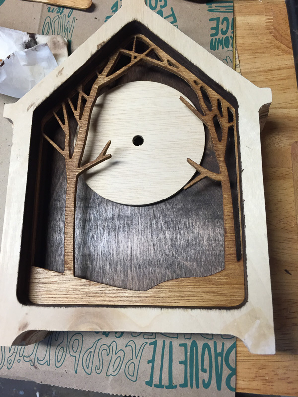

I made these 5 shadowbox clocks as xmas presents for my parents and siblings. It was my first real project on the X-Carve other then upgrade parts for the machine. All the parts were cut in Easel from illustrations I did in adobe Illustrator and imported as SVGs. I was very happy with how the machine performed.
The only issue was when I tried using tabs, they tended to cause strange behavior, that would cause slipping in one axis, or have the bit drive across the middle of my part. So I ended up just cutting almost all the way through, and then used an xacto to complete the cut.
The thicker “frame” pieces are made from 1/2" birch ply which I cut with an 1/8" 2F spiral upcut bit. The thinner pieces are 5/32" birch ply, cut with a 1/16" 2F upcut bit. I stuck them down with spray adhesive to a waste piece of MDF that I level-cut first.

No. I had thought of cutting the clockface, which is suppose to sort of be the moon, out of translucent white acrylic, and then lighting it from behind. But time and budget didn’t allow for it.

I think your’s is mostly laser-cut isn’t it? When I was designing mine I sort of wished I had a laser so I could do something more delicate and detailed, but since I have a CNC router, decided to go a bit more chunky and folky.
it was all done in easel. 1/32 fishtail bit
Awesome, what’s the material?
white styrene
