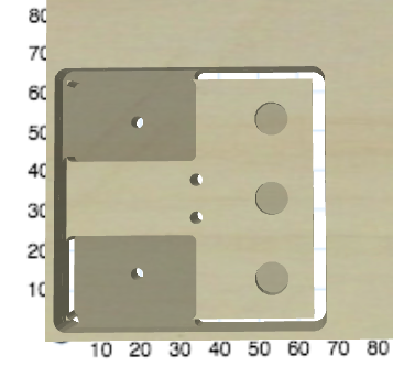

so this is a project that I have been working on and for some reason when I ask the two shapes to line up in the bottom left corner it makes a huge tab, As you can see the top left shapes lined up as i asked…
what im I doing wrong?
Thanks Adrian

any help? I am starting to think it has somthing t o do with the detailed preview that is messing things up

ok ill just take a snap shot as i dont know how thats done
Screen Shot 2020-03-14 at 10.58.56 AM
those tabs around the top and bottom on the left should not be there, its supposed to cut all the way through and it has nothing to do with the tabs setting as there really not tabs…
Screen Shot 2020-03-14 at 2.29.17 PM
this is the exact same file as in the exact same cutting settings but it does not have those huge tabs
Select the outline, go to EDIT and select BRING TO FRONT, that should fix it.
