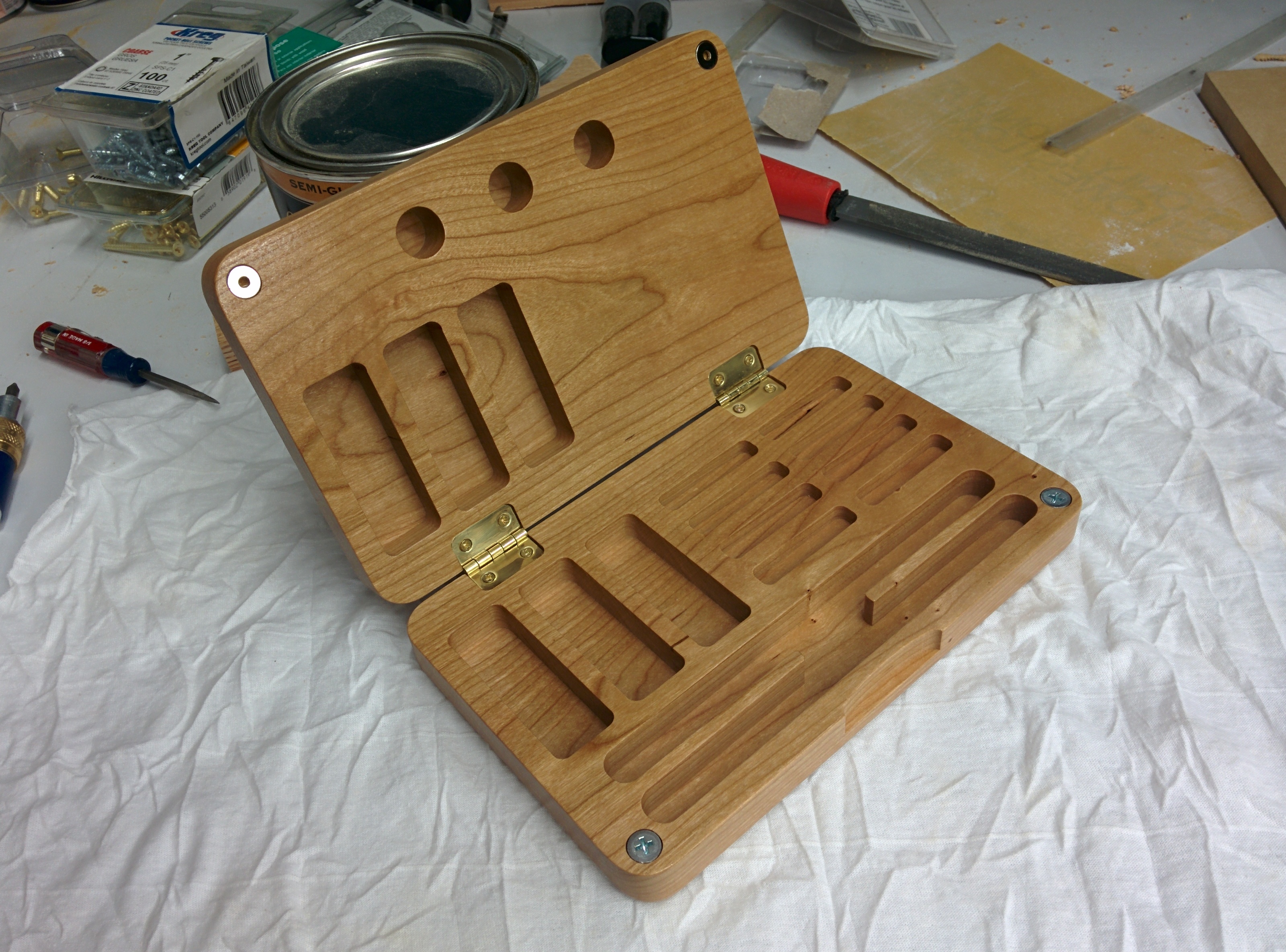

I’m using an Onsrud Uniflute downshear 1/4" as my primary cutting tool actually. It leaves a superb surface finish, although it feels a bit less well balanced than a two-flute, maybe a slight bit more vibration? Kind of odd. But it works extremely well. I’ve been using it extensively on cherry, walnut, soft maple, and pine.
EDIT: These are all photos of pockets cut with the Uniflute. These have all been only extremely lightly sanded with some 320, if they were sanded at all.

Looking sooooo beautiful.
Thanks! I’m having a blast with the X-carve in general. The stuff it’s letting me do is awesome. :smile:
Beside machining, your finishes are perfect. That is the biggest problem I’m having. What’re you using especially for dark brown one.
All of the finishes there are just clear polyurethane, no colour at all. That is Minwax “Helmsman” outdoor-grade, in semi-gloss. I spray on two coats separated by about an hour, let it dry for ~24 hours, then sand lightly with 800 grit and give it one more coat to finish.
