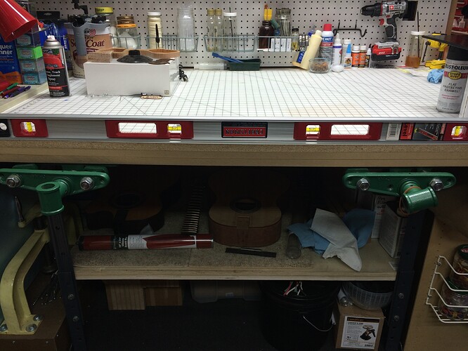

I want to share my experience with layered MDF as a table top. I am not referring to a torsion box. What I did was laminate three layers of 3/4" material together. The bottom two layers are MDF, where as the very top layer is a coated particle board. The overall thickness of the table top is approximately 2 1/4" thick (58mm). These three layers have been glued and screwed together. Overall size of the table is 41"x71". I have plans to skirt the table with 2x stock but I just have not gotten around to do it yet. I am using two sets of legs to support the table. These are the heavy duty type sold by grizzly. The span between them is 43".
After about 6 months of service I noticed a significant sag in the middle of the table between the two sets of supports. In the 43" span between the supports the sag accumulates to a whopping 6mm. This means the center of my table sags a total of 6mm in the center of a 48" straightedge (Level).
Now I realize that there are ways that I can reinforce the table to bring it back to flat and try to keep it that way but I am not going to mess with it. I will be rebuilding this top and replacing it with a torsion box assembly.
considering my shop is humidity controlled, I would only assume a shop thats humidity fluctuated, A top like my current one would be in worst shape than it is now.
I don’t recommend just laying multiple layers of MDF for tabletops unless they are fully supported underneath by a substructure. When using MDF as a table surface, it has to be fully supported underneath by a grid of some sort. What’s the magic spacing distance for the substructure? Can’t tell you that for sure, but knowing what I know, I would rather overbuild it than under build it.
