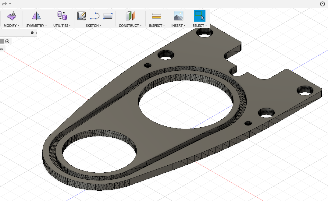

HI all,
I am back again. I followed your recommendation to export my project to a DXF file. First I created an easy drawing in the freeware Draftsight (similar to Autodesk Autcad, but for free) and saved the file in DXF format.
Now I imported the file to Easel, It works very good, but . Now I have one small issue , may be you can help me with this how I can manage it.
I also attached my DXF file, in case you want to follow my issue what I have with EASEL.
After my import of the DXF file, I had to manage several lines to decide if the router should cut inside or outside. which I managed finally.
Now my question is how can I explain EASEl to cut the red area 4mm depth (total material should be 8mm. I have to lines with 5 mm distance in between.
Is in the dxf file a mistake which I need to generate my original drawing in another way, or how can I explain within EASEL to run several paths inside the red area that I have 5mm a depth of 4mm.
Absaugung_Fuss.dxf (93.1 KB)
Attached is my DXF file.
May be I should learn to work with Autodesk fusion 360 ;- ) which looks easier to handle the transfer of the drawings to carve my projects.
Hope someone can help me.
Hi,
Could you share your Easel project link? Do this by going to File / Share in Easel and then click “Shared with link” and copy/paste the link here.
Thanks. I think the problem is that the 2 concentric shapes that you want to fill between are not closed lines. They are 4 separate line segments that are next to each other. Easel does not currently have a feature to connect line segments that are close to each other. This topic might be helpful: Closing dxf file loops-need help converting [SOLVED] - #2 by B.F
Once those 2 shapes are closed, you can make them “Fill” shapes in Easel, set the inner one to a depth of 0, and combine them.

OK,
now finally I managed it with both of your explanation and the video with Inkscape about the DXF file,
Here the result.
Again big thanks to everyone.
But honestly , I thought that EASEL could do this … Anyway…

Looks like a dust shoe?
@T.Pruefer, was the original design made in SketchUp?
That’s what it looks like but I was wondering how it would attach to the X-Carve.
Thanks Russell
Hello,
yes it is true . It is a dust shoe. I was looking for a solution to look during the carving inside the area, which was not possible in most of the solution which I found. SO for this reason I found one in the §D print world.
All of the parts you can print with a 3D printer or of course you can design it with wood and the dust shoe itself would be out of acrylic . Which looks very similar to the suckit design.
Here the link from the Thinkserve website which I used to download the files.
There are different files , but I was not able to change the hole for the dust connection , I wanted only 35mm instead of the big hole which was originally in.
May be there is an easier way to use one of the files.
Let me know if so.
Hope this helps you as well.
NOTE: I just added out of my workshop this infomration. WHich bit you would use to cut this acrylic out ? I am now using the 1/8 inch Upcut bit from inventables. If I am right , I am not using the recommended speed , do you have also some sugestion for me ? with the plunge rate, feed rate and depth per path ?
