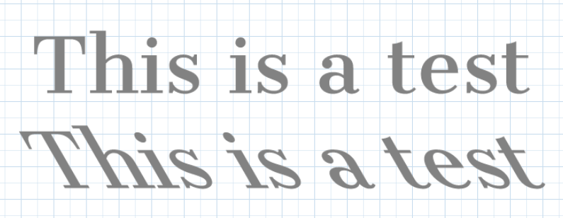

how do i make a skewed image
in easel

Hello group.
Has the skew function been added since this topic first came up? Or am I missing it somewhere?
IF it was released then it would appear with the other Apps (found by clicking the LEGO icon on the left side) Buuut it is not in there, so appears it was never fully released.
