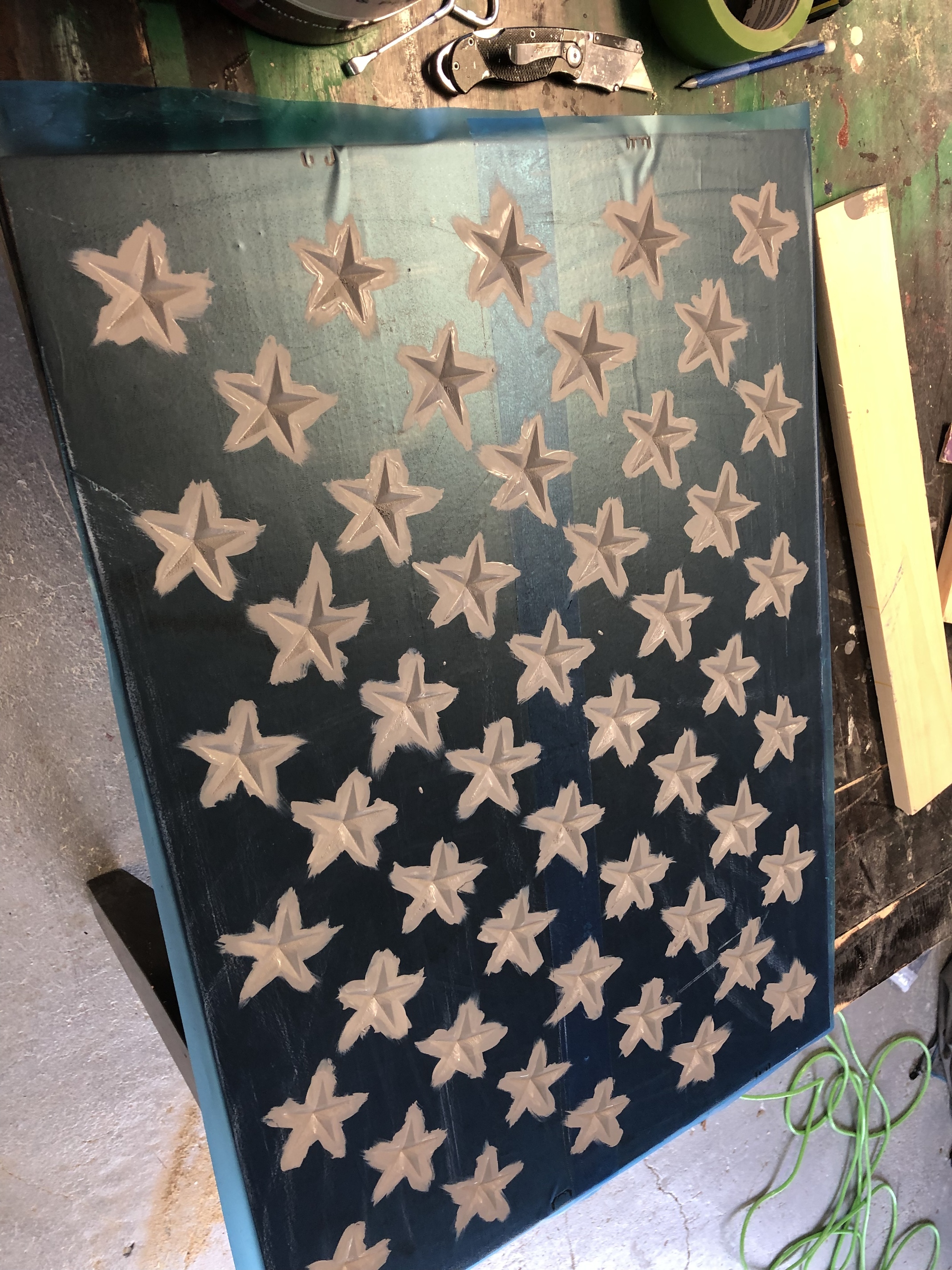

Well, after a short break from work, a cold beer, and a long drive, I revisited the issue at hand. Managed to repair the broken Z axis switch, rehomed the machine and went to work. Wasteboard is nearly perfect, and my work was nice and symmetrical. Here’s a few picture of what I put together.
It’s for a company, that’s their logo. They requested it. Here’s a few more I’ve done with the X carve. This particular flag was big, the Union (star section) was 30” wide, so the machine being out of alignment really showed itself. On smaller flags, not so much.

Thanks Christine, it depends on the size of the flag. For the larger ones, I like to use the 120* V Carve bit from Tools Today. I bought their sign making kit, AMS-132. For smaller flags, I use a 90* V carve bit.
