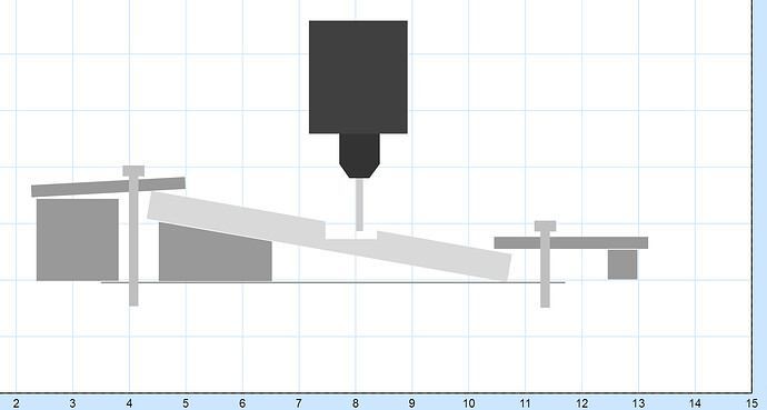

I’m sorry if this has already been talked about, but I am new to the community. I want to make a board with pockets for playing cards, where the pockets are more deep on one side than the other. I’m only looking for a 10 degree curve, any tips? Can other software accomplish this? Or maybe the x carve can’t create a smooth enough surface?
JDM, you just blew my mind! How simple. I cut some 70 degree angles on the table saw that will be perfect for the CNC. just need to cut a 20 degree base. I love this place.
