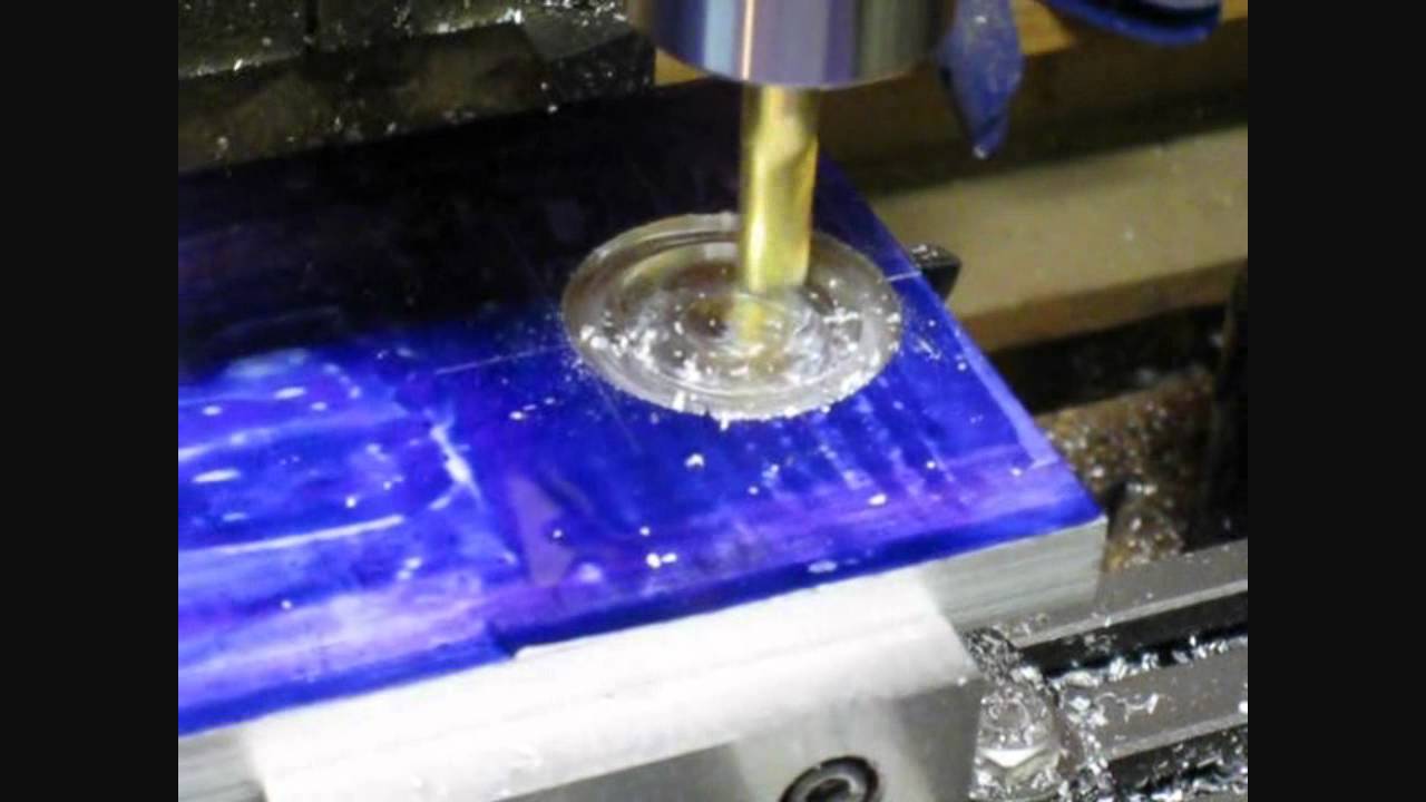

I just found a possible use for it. Has anyone seen these conversion kits that convert a Harbor Freight mini mill into a “high precision” CNC?
about $700 for the mini mill plus about $629 for the conversion kit. Not sure but it does not look like the stepper motors or controller are included. So the X-Controller and three motors should finish it off nicely.
