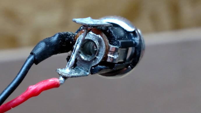

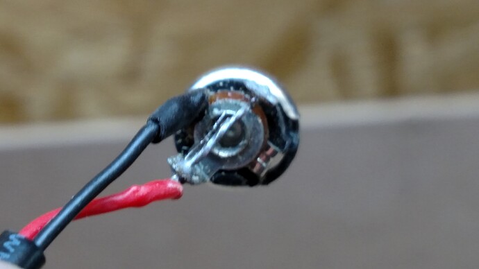

Ok,
So based on the last message that I got from picsender, I felt that it had to be a hardware issue.
I did nothing more than a simple continuity test on the probe wires.
It doesnā€™t make any difference which wires I check they both have cross continuity.
(which to me, doesnā€™t seem right)
Now Iā€™m not an electrical engineer, but can someone explain this wiring at the plug?
Nor am I but that look odd to me. Snip of the red wire extension to the 2nd pin, so that only the center pin is connected to red wire. Easy enough to go back should it not behave differently.
Cross continuity = there is a short somewhere for sure.
