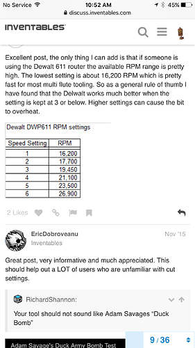

Also. When your using a spindle with a manual speed dial , the settings in Aspire won’t do anything. That is used when you have automatic spindle control. And the tool number is used if you have a ATC (automatic tool changer).
Here is the speed setting chart for the Dewalt.
Learning so much with this thread! Any suggestions about my bit choice posted at top? I also have 1 and 2 flute bits. The 3f bit I’m using now is my only one and since it ran off twice, is it still usable? Even if it looks clear to the naked eye?
I would change to a 1 flute bit. The Dewalt is just to fast for a 3 flute bit in AL. The feed rate formula looks like.
Feed rate(ipm)= RPM X Number of Flutes X Chip Load.
So if your bit needs a chip load of .019 to stay cool then 16200 X 3 X .019 means you need to be moving at 923 IPM. Not on our machine any ways lol. So we need to do other things to help out. Get an air assist of some kind to constantly blow on your bit/work also keeps chips clear. Use a lot of lubricant and clear the chips very often. W/D 40 works good. The off set TP helps tremendously.

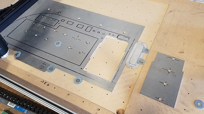

SUCCESS!
First, I need to start out saying a HUUUUUUGE THANK YOU to Mr. @CharleyThomas for the tremendous amount of help he was to me this week. As it turns out, after purchasing his auto zero, I discovered he lives around 200 miles north of me. After talking to him all week long via email, he volunteered to drive down and help me get my machine tuned up for turning parts out. How do you say no to that?! It was an awesome two days of learning from him.
So, after a week of trying several panel cuts trying to get the combinations down to something that’ll do what I need it to do, I have finally found a winning formula! With Charley’s help getting my machine straight, my table correct, and my bits in order, together with the information found all across this forum, my very first CNC’d part is just about ready. After several successful and repeatable test cuts early this morning, I’ve decided to move on to my final piece and so far, it’s been spot on.
Thanks to everyone who’s contributed to my question as well as commented on others questions. Using the search box, I found several people who’ve posted within the last year with information I used to get to where I am at. So, here’s my combination of success. It’s by no means the best option, it’s just an option. One of many. Probably slower than most of you guys, but it works and it’s repeatable. I can even take the part out, mess with it, and then place it back down and continue back on track like it never moved which is awesome. Eventually i’ll find faster ways of getting these done, but for now, any panel we can put in a customers plane is a good day for all of us.
My formula:
.090 2024 aluminum
2f down cut Destiny Viper bit .125
Dewalt 611 speed 1
DOC .002 (slow, but turning parts out is better than more test panels stacked up)
FR 25" ipm
PR 10
Single channel (no fluting or widening the channel to relieve heat)
No oil
Worked like a champ! Takes a while, but so far it’s awesome!

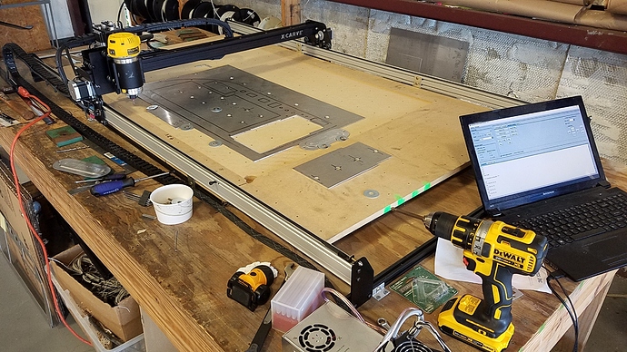

Here’s a pic of some test panels I was using as well as the final panel still being worked. You can see the panel is so huge I finally figured out that I need to bolt it down in the middle or my cuts won’t work.
And by the way, a mini sharpie screws right up into the 611 with the chuck removed. Makes it AWESOME to draw out where my cuts are going to be, then remove the panel and cut out everywhere my bolts can go in the middle and not be in the way. Glad I found that out early on while searching for a way to accurately and quickly see if everything is good to go.
