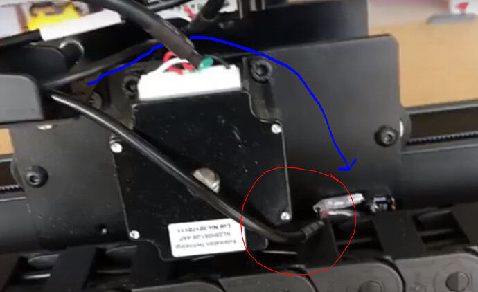

No this location (in the red box):
Unrelated to the lack of movement issue, your limit switch wire is rubbing on your drag chain:
Route the wire over the motor to avoid future problems.
