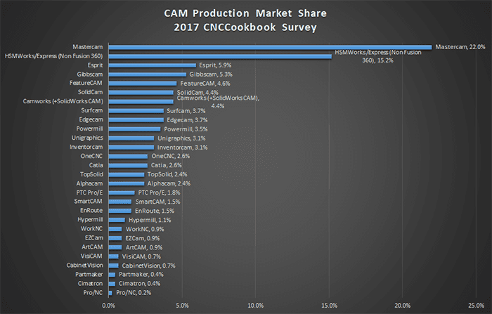

Then a CAD CAM software + a very accurate digital ruler,
somethin like this:
to make the parts i need, for the next modification.
when that next modification is ready, build parts for the next level modification.
building muscle every step of the way.
will try NX Cad/Cam 30-day trial first…
but probably will end up using what everybody does:
maybe Cinema4D next…
Rhino3D, etc…
