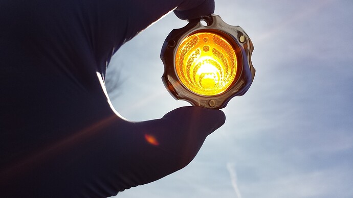

Made a key chain from 1/8 steel and some leftover acrylic from jtec
The steel was cut on the xcarve then sanded and electropolished then finished on a buffing wheel.
The acrylic was done with the jtec 3.8 watt and also cut out the the jtec.
Brass rivets were made from some 1/8 rod I had and were annealed prior to installation.
Time was about 4 hours over a 3 day period.
the photos here are after sanding and after electropolishing
and here is after electropolishing then buffing I could further refine the polish with another dip in the electropolishing solution
etching vid not the best but it gives an idea.

I know people might look at me and shake their head at me cutting steel on a xcarve. I know a xcarve is not even close to a haas cnc machine but when you have seen a cnc milling steel at 15,000rpm moving 300ipm doing production work and getting 18 hours of tool life The crazy in me says hey I gotta try that.

Wall charger or battery charger and a few chemicals thats about it. same as electro etching and opposite of electro plating.
I should have choose my wording better. what I did was more of a etching process to remove some scratches to give better results when polishing. The process I am using by the time it would polish it would also be pitted very badly but that also can be used to give another look to a item.
