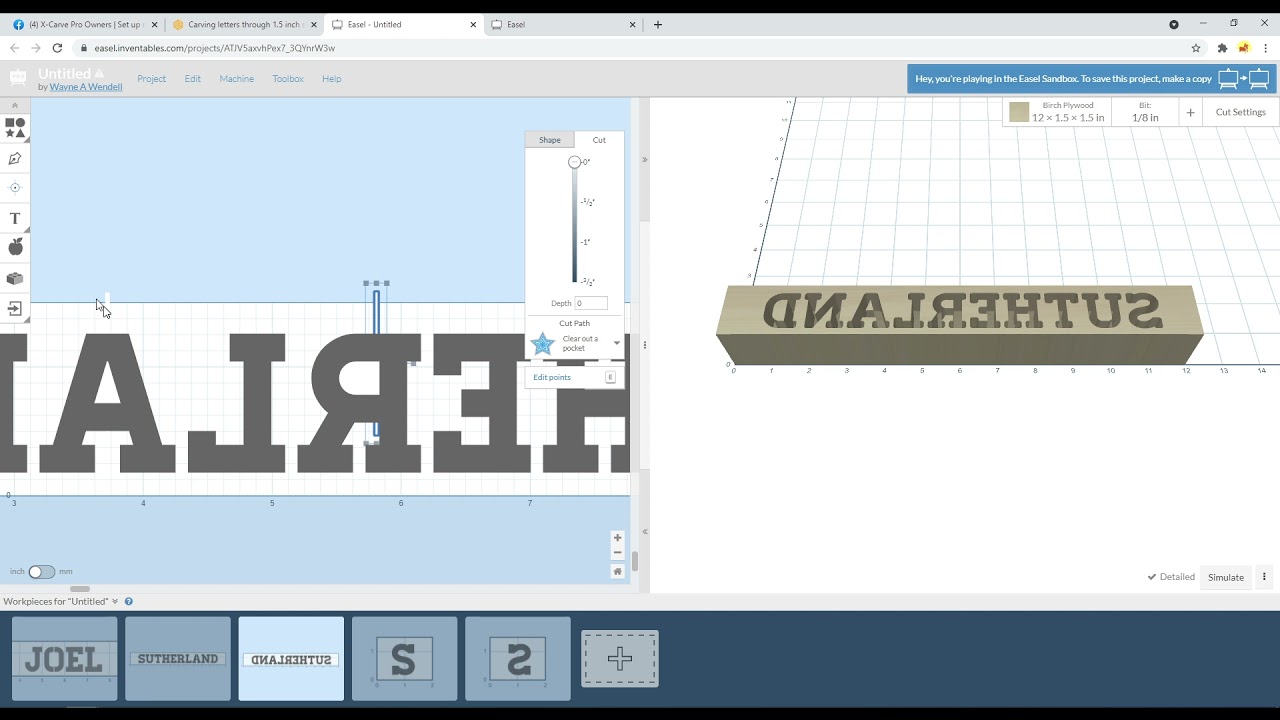

When setting up text I set the height at 5.5 inches but comes out only 3 inches in height can’t figure out why but shapes come out at set dimensions any help would be appreciated.
Your text is measured by your bondery box around it. If you want 5.5" tall letters draw a 5.5" tall rectangle and adjust the height to it.
I made this video for someone else, focusing on a different problem, but watch through it and you’ll see the part that shows the issue your having and the best way to fix it…
Changing it from editable font text into a noded vector design…
I use the combining a 0 depth shape method to perform this function.
Here is another showing the same concept with script font…
