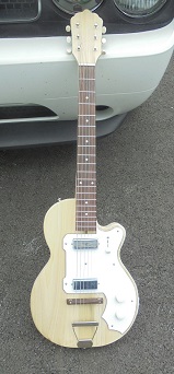

If you are using a regular hotrod, you can delete the curved vintage style rod and replace it with a straight slot that is 7/32 wide by 7/16" deep. The low profile one probably has a different set of dimensions if it anything like those other blue wrapped rods. I installed 5 of those and found that I spent more time fiddling with the 2-3 different routs necessary to install it, that it wasn’t worth the cost savings over the original hotrod. This is my latest guitar made the last month. It is Kay 142 inspired. It’s all hand done except the pickguard and rosewood bridge which I cnc’d.
kayfront small
guard
