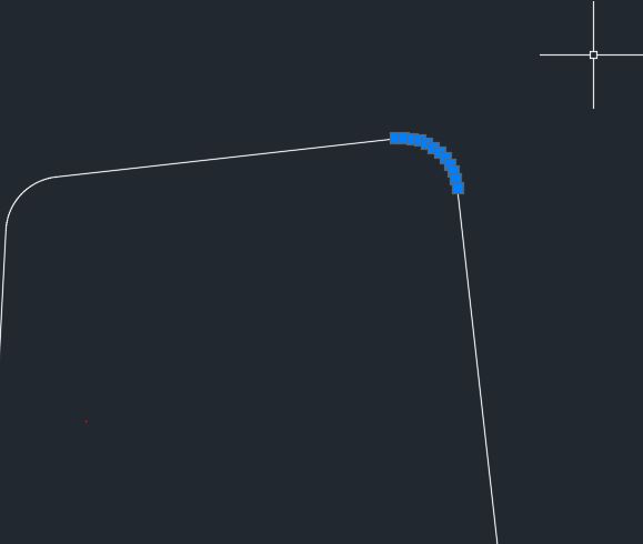

I’m trying to cut a simple shape - A DXF exported from Fusion 360.
The problem is, the curves won’t allow the line to close, so I don’t get the inside / outside option for my silhouette.

To follow up, I found a solution that worked for me – Autocad. It’s not sustainable for me as I’m working with an educational license that will run out soon, but if anyone is in school it might help you out.
I brought the dxf from Fusion 360 into Autocad and followed the following process:
https://knowledge.autodesk.com/support/autocad/learn-explore/caas/CloudHelp/cloudhelp/2018/ENU/AutoCAD-Core/files/GUID-0B3942B9-6CC2-4669-89DA-DD6AAC180B85-htm.html
Clicking modify > icon > line > enter to convert (on all curves).
