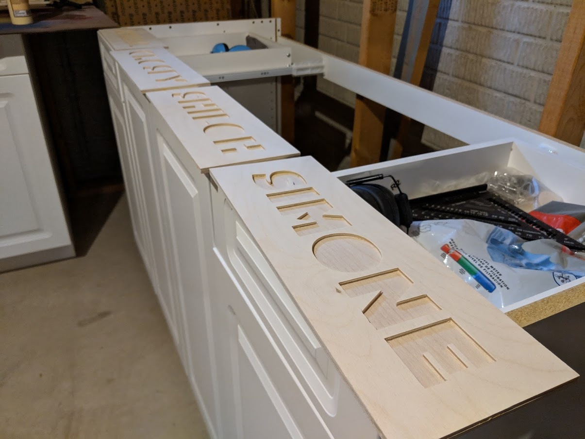

I opened up orders for a recent project and they are flying out the door. This is the first set of 9 that I did with more orders coming in now. A super simple project that is easy to batch out.

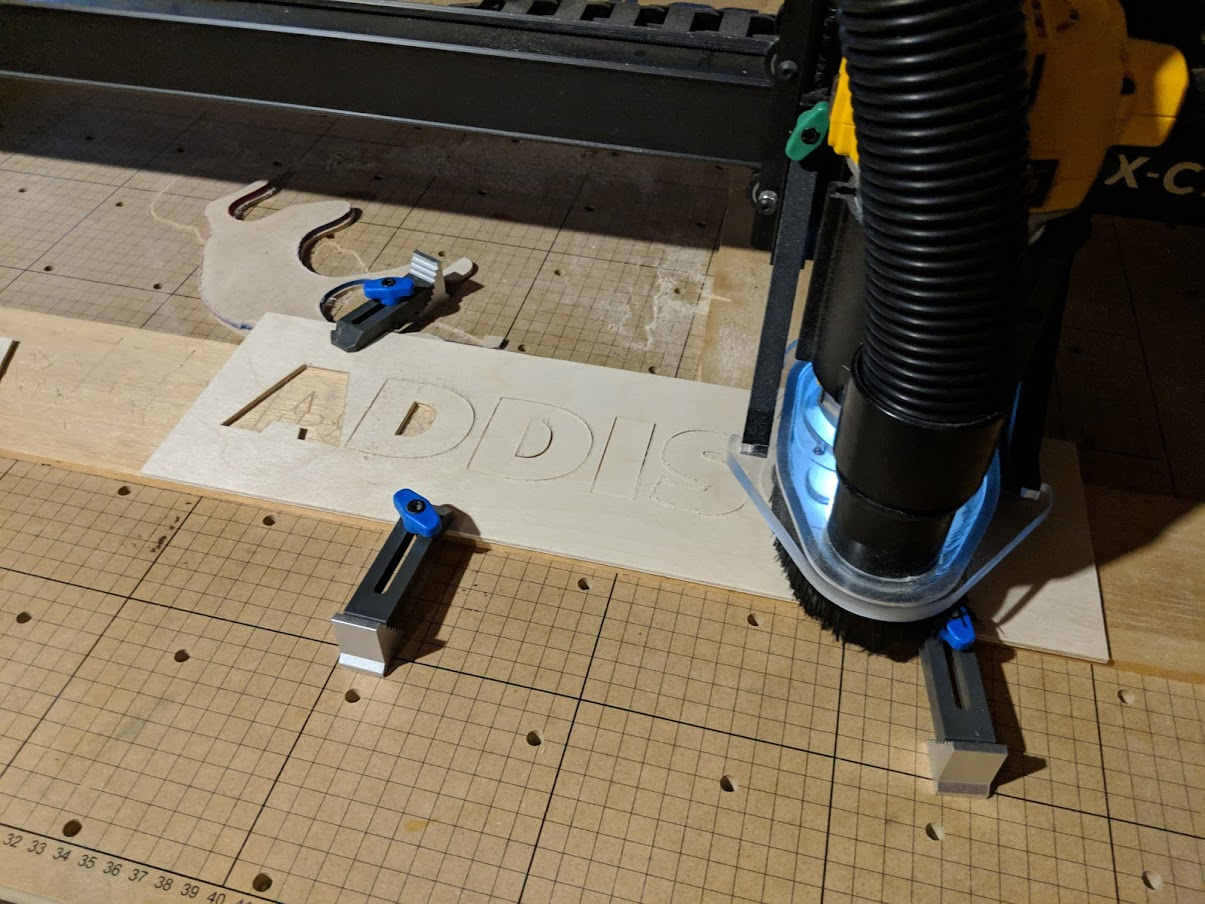

Cut out of 1/8" Baltic Birch plywood. Added tabs after a letter popped out and got ruined.
Organized all the letters next to the color that they will be painted.
Post glue up to backing boards
Engraved my signature and year into the back of each by scanning my signature and using Easel to convert the image to linework.
The two finishes I’m doing. Stained with Dark Walnut for the prototype for my daughter and all the others finished with Tung Oil

what do you sell one of these for? What is the overall rectangle size? Do you just cut the letters out with a 1/16" end mill and glue that to another piece of plywood? They look great!
@Winters636 I price these at $20-$30 depending on the length of the name. From a full sheet of 1/8" piece of Baltic Birch ($14ish) I can get approximately 27 completed puzzles. Height is 5" tall, length is dependent on the length of name. Process is the following
  1. Cut out the letters with a 1/32" bit with tabs (approx 14-20 min with recommended settings in Easel)
  2. Cut the letters out of the piece using a utility knife
  3. Sand the backing
  4. Glue the front to a blank backing to the backing
  5. Route an 1/8" roundover onto the face of the backing
  6. Sand everything
  7. Finish the puzzle with tung oil
  8. Paint the letters the requested colors
It is best to batch these out as much as possible because the time in which the X-Carve is cutting the next puzzle is best used sanding and gluing the previous one.

Last question, do you think you could cut these out with a 1/16" bit or would that leave too much play in between the letters and the backing?
1/16” bit would be too big
