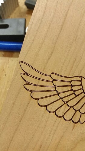

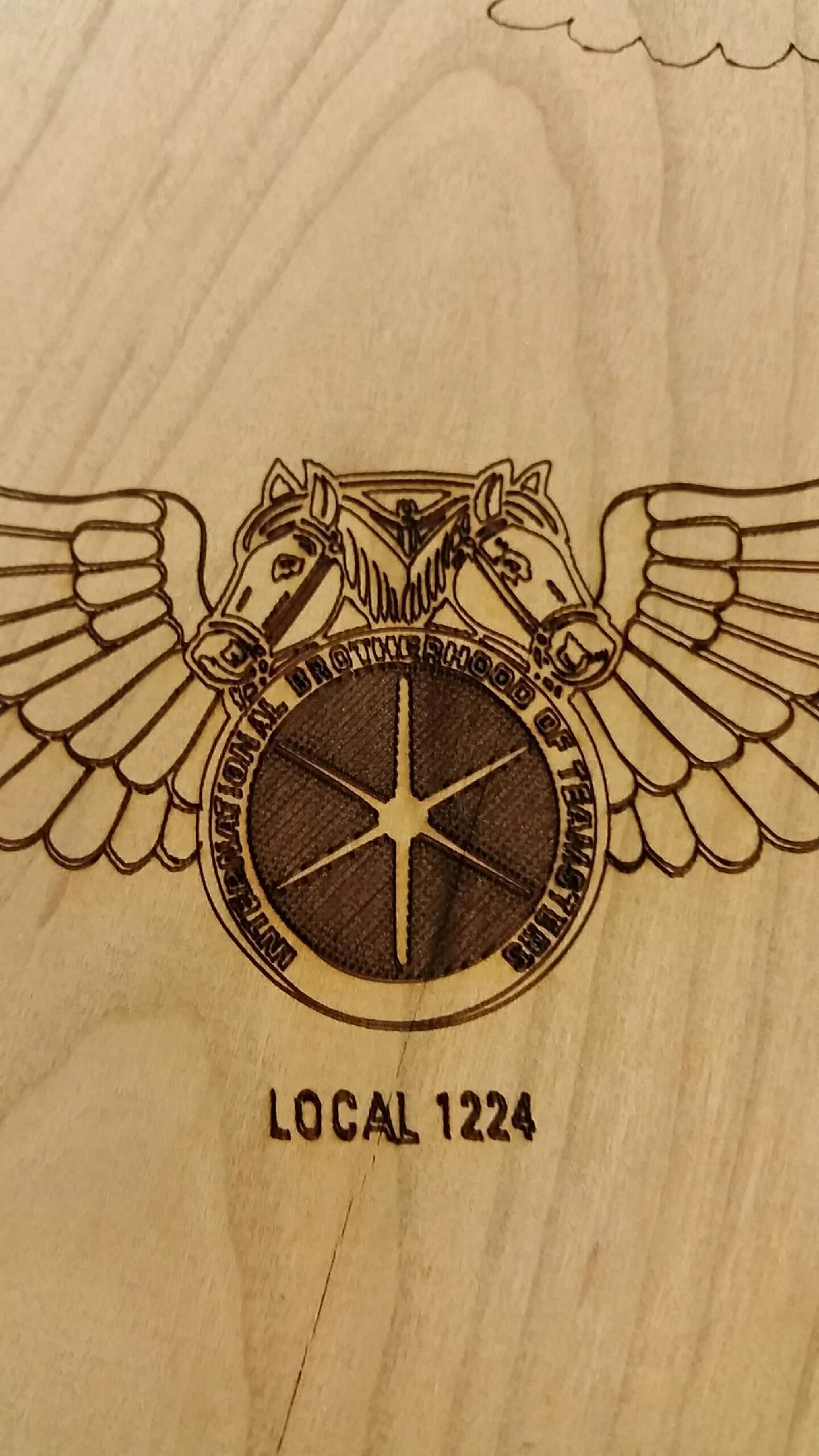

Attached are photos of a recent laser carve which are demonstrating my complaints
Note the bottom of the two concentric circles around the main logo
note the tips of the feathers on the wings. the entire engrave should have an equal space along the outline of the feathers.

I know you’ve said you’ve tried everything, but just to ask a dumb question- have you tried adjusting the V-wheels on your X-carriage assembly?
I only ask because I was having the same problem. Circles would be close to nominal in the Y direction, but severely undersized in the X direction. I loosened up all X-axis V-wheels and started with setting the top ones FIRST (non-adjustable tension) then the bottoms. Snug, but not TOO snug.
If they’re too loose or too tight, you will get half-assed circles that don’t come out right. There is a sweet spot somewhere in there that you will have to find. I’ve also found that my circles vary depending on where they are cut on the machine. I JUST added stiffeners to the Y-rails so I’m interested to see if this helps out at all.
