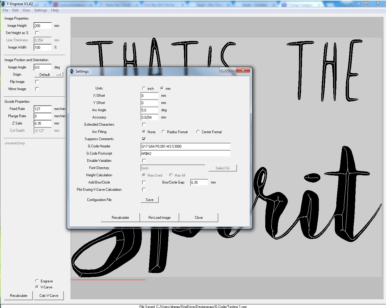

I had a play with F engrave yesterday. Created my G Code OK after a quick read on the forum after Easel got a little upset about some settings. Ran the carve and it all started OK, got to 6% and froze… i left it for a few minutes to see if it was a glitch but after 5 mins I gave up stopped the carve and then restarted it but same thing.
The #1 and #2 are g-code variables. They will not be used if ‘Disable Variables’ is selected in F-Engrave general settings.
(This is not a new behavior.)

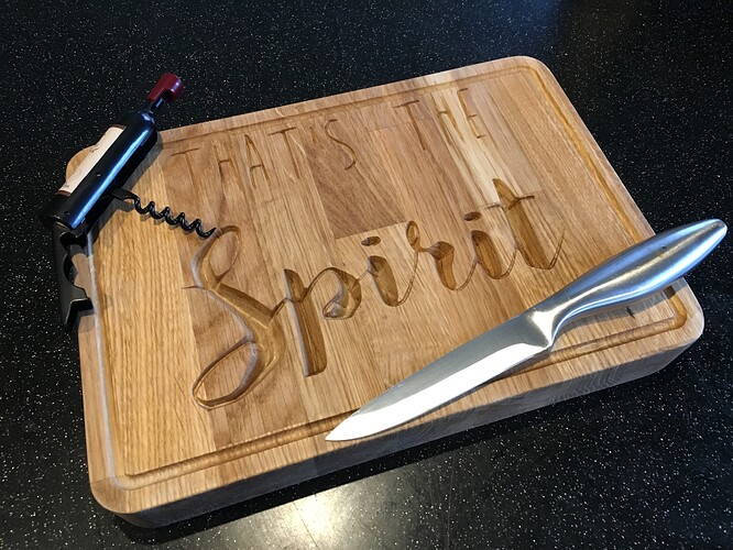

This brings me on to my next problem. So i’m making a cutting board, i want to use F-engrave for V carving the text and then cut a rectangle around the text using a ball ended bit and finally cut out the outer edge with a straight 1/4 bit. This will mix using the G-code and then normal easel for the rest of the bits.

I think i’ve made a *ock-up then. When i’ve done the BMP file to read in to F engrave, i’ve not been concerned with the size. I’ve then scaled it in Fengrave to give me the hight of the Vcarved bit. So the Zero point for the V carve section and the Easel part won’t be the same.
I think i’ll cut the board out and do all the easel carving, then messure in to find the Zero point for the Vcarved text and repossision the machine. Fingers crossed, I’ll know for next time.

Well here is my attempt. I don’t think i had the cut setting right, i think i had the depth settings wrong. I only wanted it to cut down 2-3mm max. The client seems happy enough though. Can’t make the same mistake on the clock faces though.
